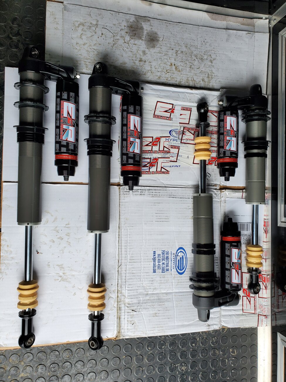

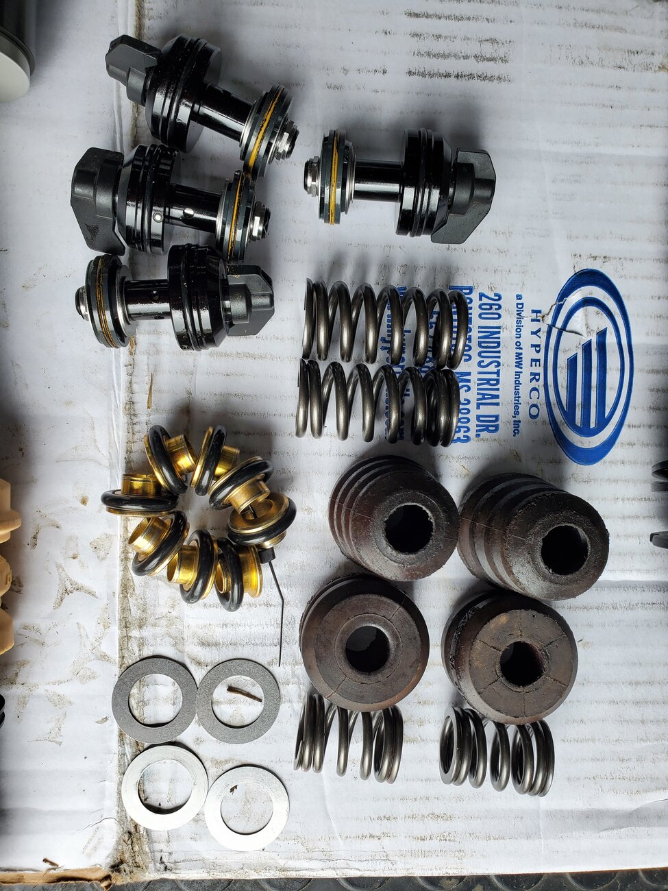

This is all the extra crap that was pulled out of my shocks.......
20210227 142220
20210227 142408
Those 4 springs are what you guys hear clunking......

What I - think - I hear is it hitting those rubber stoppers HARD.
For me its a hard bottom, thump.
Those rubber stoppers in my picture are the old bump stops that came off the shock shafts, there are no rubber stoppers inside the shock. The small springs in that picture mount under the piston around the rod and make contact with the inside of the shock an inch or so before it fully tops out and compresses the spring, that's what you are hearing. If you limit the shock so it doesn't "clunk" you are losing travel.
Have you ever checked the nitrogen charge in your shocks? Low pressure can cause the shocks to be overly noisy in my experience.
Reactions: Remington
