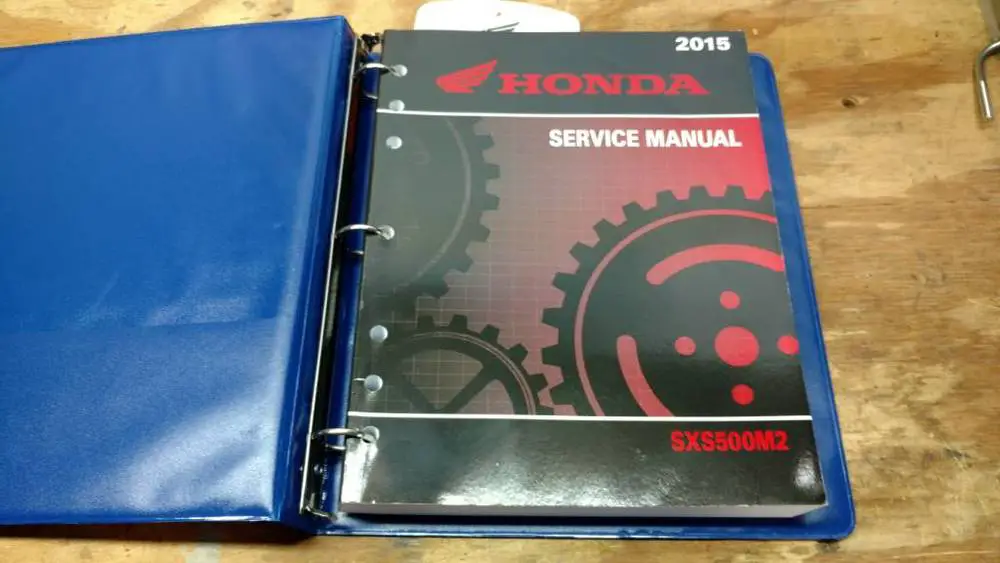

FYI, not sure what it costs cause it came with the machine, but this service manual is nice and saved me a lot of guess work.
Just saying.
A4b3b95507b2ac8c9fbbad718bdf0df7

The first year manuals hover around $100ish. 2 year+ manuals, like a 15-16-17 are right around $50 new. But they are definitely priceless.
