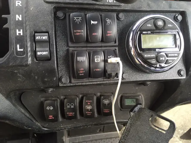

I have the OEM panel and a custom panel I made.
The OEM panel is expensive but I like it. However, if you choose to use aftermarket accessories, it will be a challenge to hook them up. I used the OEM panel and custom wired my own accessories into it. So basically, I bought it just for the switch panel and additional fuse box.
If you use Hondas accessories, they are all ore wired and it will be completely plug and play.

39,129
Here's a pic of what I got and if you choose to embark on the custom setup, there are plenty of guys willing to help you accomplish this.

Thanks, Joey! After looking at your pictures, I thought about the aftermarket plate having the advantage of not taking away the bottom cubby. I am not planning on putting a stereo in and the bottom cubby is where I put my UE Boom so that I have tunes while on the trail.
Looks like I have a lot of reading to do on the build threads in order to learn how to do the aftermarket switchplate.

Hi Joey - two questions for you, on the Honda accessory plate, did the switches you have snap right in or did you have to modify the honda plate to accept them?
Secondly did you get them to work with the honda wire harness or did you have to custom wire it? If you don't mind would you be able to tell me what you did?
I'm a new p1K owner and have just ordered a winch and led light bar. I have the honda plate mainly for the location and look of it. Thanks for your help!

I did use the OEM wiring and fuse box. It wasn't too bad. OEM has wiring for 4 switches already behind the switch panel so I just used a meter to find out which one was hot, ground, etc.
The OEM has 4 outputs which you will need to make your own plug and wire to go to accessories.
And yes the switches do just snap in.
If you have any specific questions, feel free to ask.
