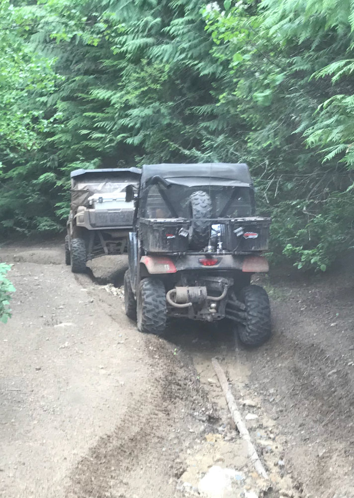

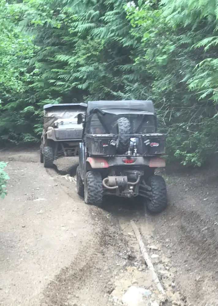

Those pictures look like riding in West Virginia, but with mountains on both sides of you. LOL
That pic use to be the road to town lol. It got overgrown a little and the rut gets bad, wider then a machine in places. Kind of a hell Mary at times now

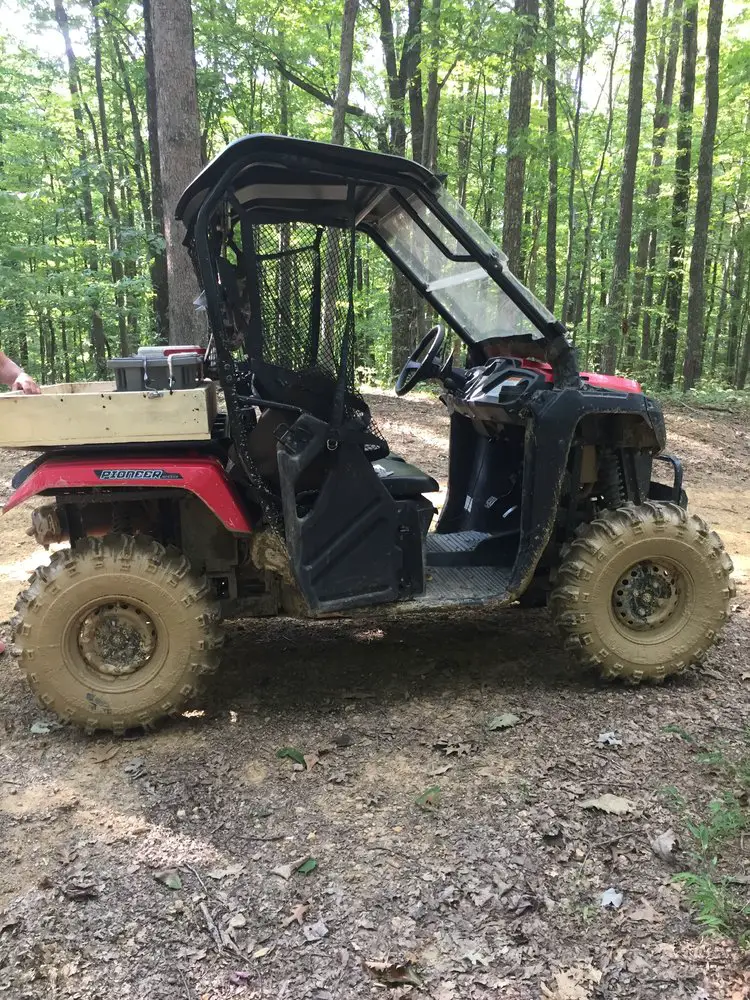

Hey Gang. Sorry I didn't post in regards to the Wolverine wheels questions earlier but I was in Eastern UT archery elk hunting and no computer.
The Wheels I have came brand new off a 2017 Wolverine four seater. Both Ft & Rr are 1" wider on the tires than stock and are 25" Bighorn 2.0 but I believe wheels are the same width. Major difference=Front are 1.5" less back space and Rears are 3" less back space - these numbers are for two wheels combined to tell you total wheelbase change. Brings the Front to a full 50" and the rear to 51.5". I went between two steel posts last week that were EXACTLY 50' inside. Front cleared but back had to squish the tires a bit but rims did not hit.
Bought these from a local guy who had 1 mile on them and put aftermarket wheels and tires on his Wolvy. I paid $275 for all four wheels and tires mounted, unused, and ready to run. About 1200 miles on them so far and they are WAY superior to the stock Maxxis tires. If you don't get too aggressive with them and cut the sidewalls, the 2.0 Bighorns offer better grip than the ones with heavier sidewalls. I really notice the difference on challenges like wet logs. On rocks they are tough as nails but grip even when wet. I will eventually probably move to rear Wolverine wheels/rims and tires on all four corners and use a spacer on rear only to even out the width. Rear axle is slightly narrower than the Front by about 1.5".
BTW-I'm running 4.5 lbs. air pressure all the way around.

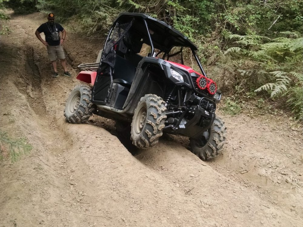

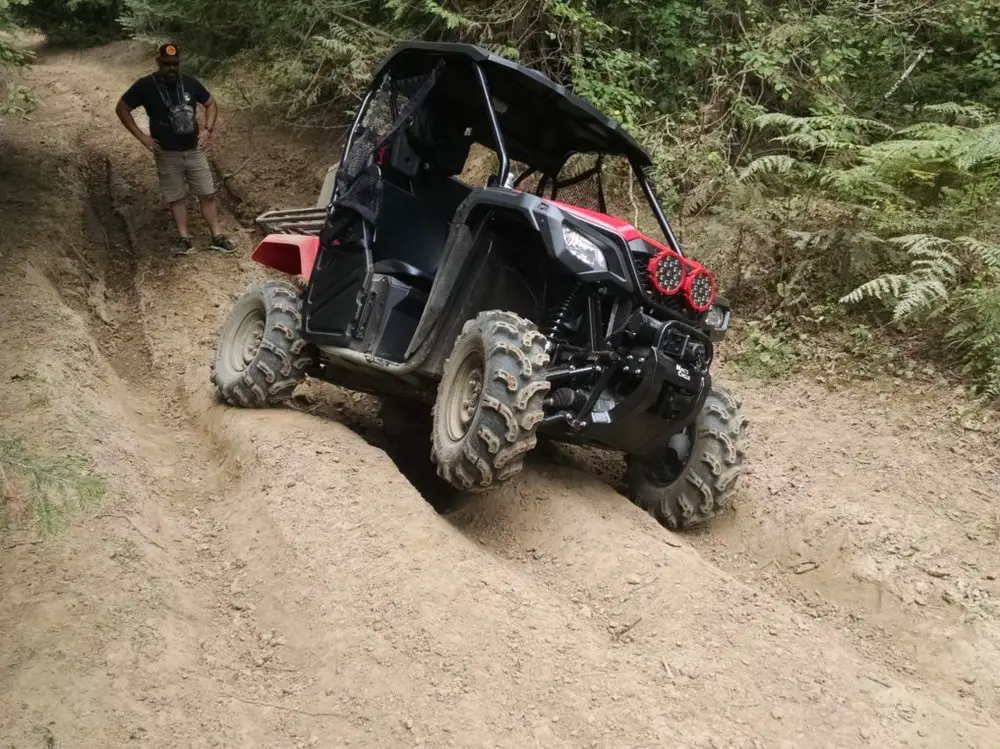

I now know why people flop these things.
My brother and I were riding in my P5 this week while at the cabin and one of the trails we took it down had some extremely deep ruts.
Picture doesn't capture the giant kelly hump and 3' deep ruts, really. Riding the edge when the back left tire slipped into the rut and it immediately flopped on it's side. No pics of it on it's side as we immediately got out and righted it.
Decided to just winch it out of the rut. Haven't noticed any damage.
With two nearly 300lb men in it plus some gear, we really pushed that poor little thing, but, it was great.
We came up a trail that was about a 45 degree angle and was so steep and rutted that we both were sticking our bodies over the hood to keep the front tires down. Very, very sketchy trail. The P5 was pushed to it's limits and was awesome.
Rode about 24 miles exploring the Idaho back country above Dworshak reservoir. Found some awesome blackberry bushes and had a great afternoon.
Yeah, ruts like those are the bane of the P5.
