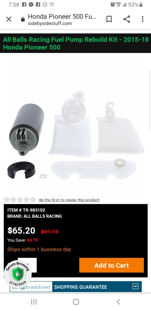

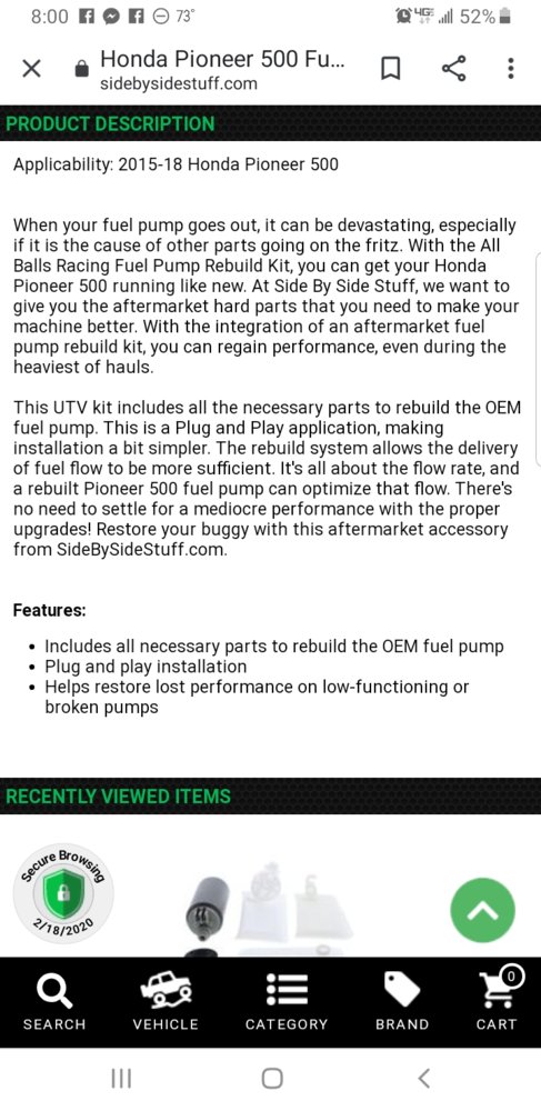

What do you think of this guy's just in case replace a fuel pump and use this possible upgrade?

The only way that will work is if you get a power commander to tune the PCM so it tells the fuel injectors to add more fuel to the combustion chamber. If you don't want to go that route you may as well replace it with an OEM pump. Your money your call.
