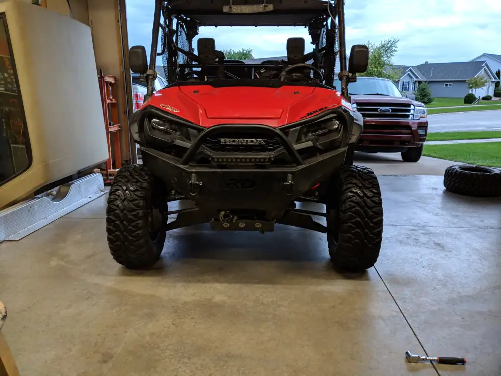

What front bumper is that?
Started as an RD. It's 1" higher and 1.5" closer to the body. The lower mounts are gusseted and tubed with a UHMW wrap for a skid plate. Winch is on a KFI mount

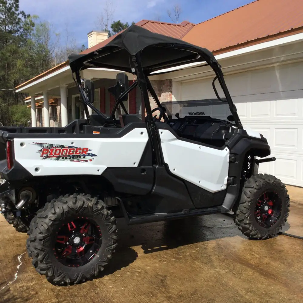

I run 28" tires on a 14" rim with 1" wheel spacers in the rear. I run 9" up front and 11" out back because in 37 years of ATV/UTV use I have never had a flat while riding.Welcome from Mississippi.

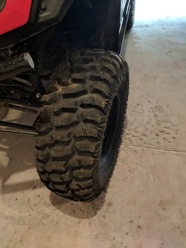

looking at getting some new tires for my stock rims. got to ask will running a 10 wide tire on factory deluxe rims cause issues. will likely do the 1" spacer in the rear. going to get skme sti outback max in 27-10-14.

I ran factory rims with 10x28 roctains and it rubbed my Walker Evan's shocks.
Put 1" spacers on front and 1.5 on rear and all is good.

will that give the sxs a wider stance? would rather go to a 5+2 rim but dont want to buy new rims. unless I can sell my stocks. lol. also my delux has stock shocks still on it.
