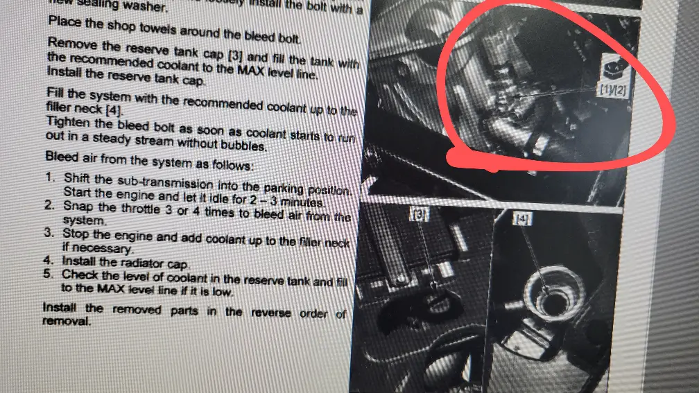

do you open air vent when running?
18,500
67,170
It didn't say to run it.. I'm fairly sure it should be off.
Here is some info.
4f673e0e0d2f390dbfb0b4293516af8b
