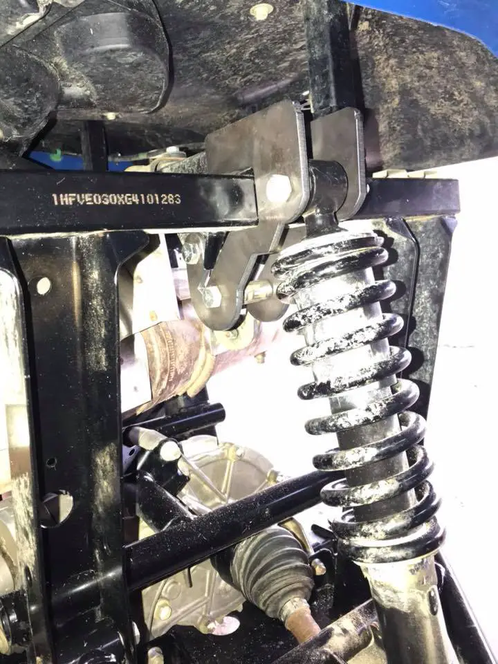

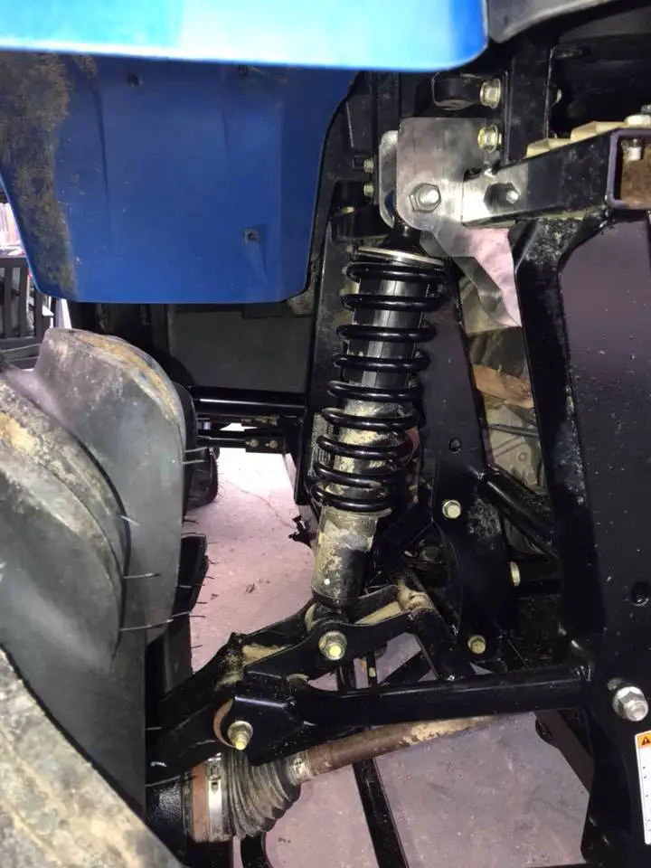

This is interesting, a two inch lift without having to change any driveline components.
So do the stock shocks limit suspension travel.....is there more suspension travel to be had with a shock that has more stroke.
I would think a longer stroke shock leaning inward allowing more suspension travel and larger tires to help keep from bottoming out would be worthwhile.
Bastardchild
Bastardchild
Nov 3, 2016
1,978
7,251
Orange Heights, fl
Ive done tons of front end work to my P5 a few months back and i was curious how far my front suspension could go down without the axles binding. I unbolted my front shock bolts and moved my a-arms down about an inch farther than the stock shock would allow and my axles binded and locked up. Now ive done broke all my stock Honda axles here and there and replaced them with elcheapo axles off of ebay or amazon. Maybe a stock Honda axle offers a little more travel. So i know i couldnt use longer shocks on mine anyway, maybe you could.
