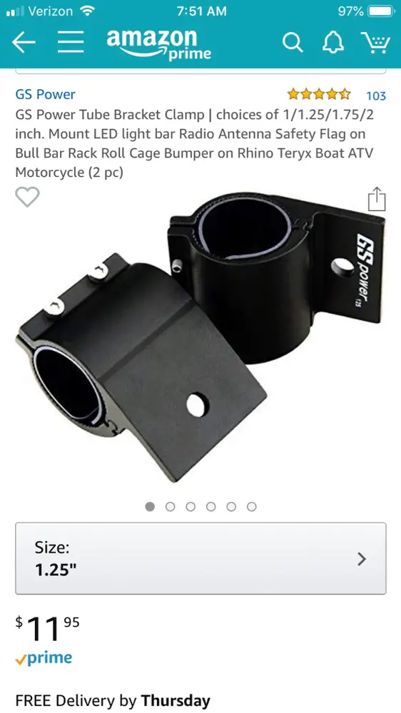

What size did you order in the GS Power mounts (thin ones)?
It was a year ago that I put them on. I think 1.25in. I fit them by mounting upside down with the screws going in from the bottom. Ill try to get a pic tomorrow after work of how I have it set up. I dont luke drilling holes.

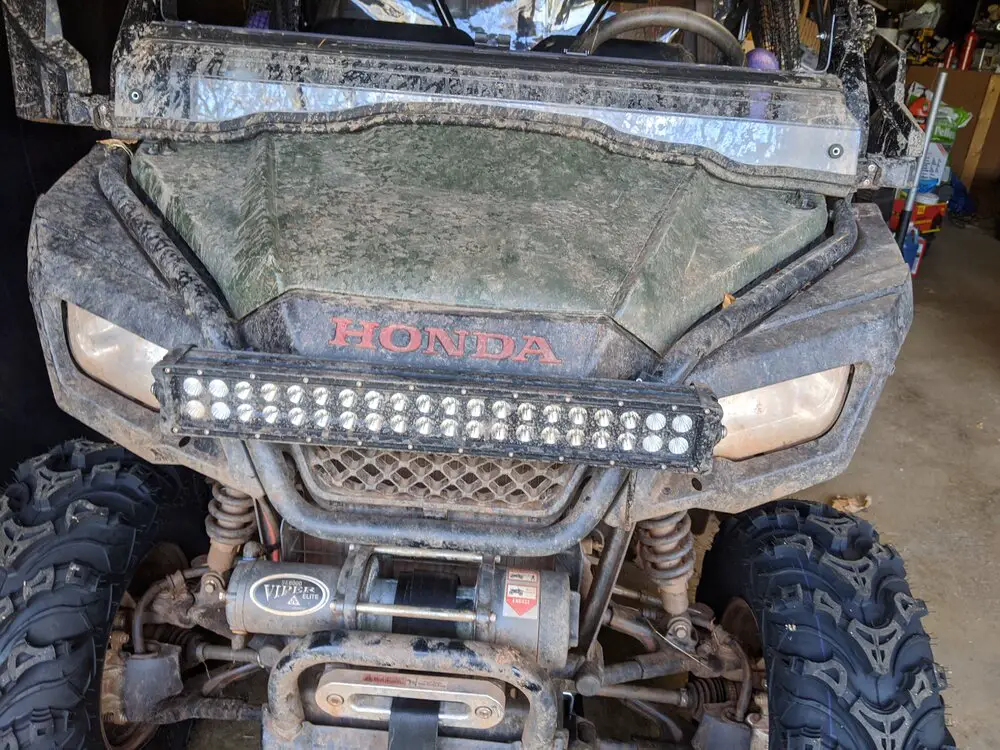

I put a 14" bar on mine from Amazon and some bar clamps. I had to fab a bracket to make it work but it worked really well in the end.

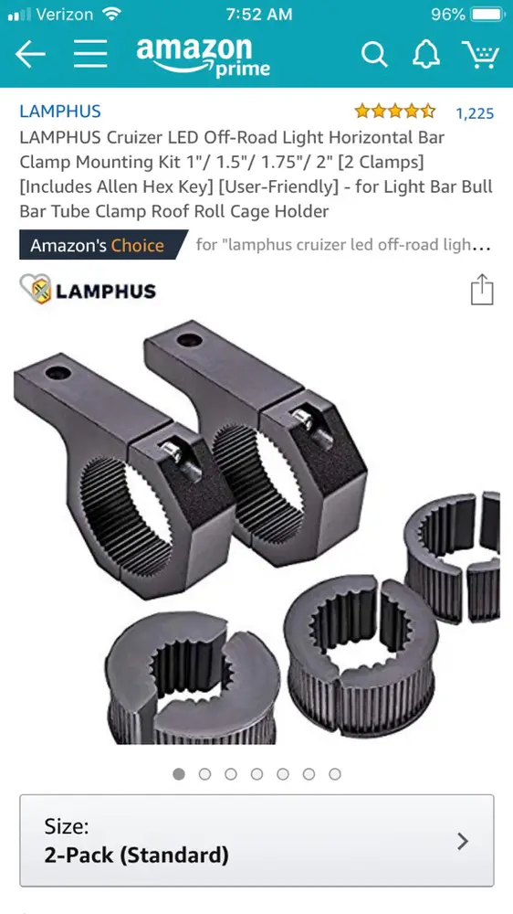

The the clamps that are more thin. Are the ones I used on the front and the thicker clamps were ysed on the rear lights. I like the thinner ones better. Use loctute on the threadsView attachment 104941View attachment 104942
I have a set of the thicker mounts that are shown in the second pic, they seem to be of good quality but I haven't found a single place on the 500 tubing where they would fit.

Want to put a 12 or 20 inch Rough Country light bar on front of my P500. I have a stock bumper so mounting options are limited. Anyone done this successfully and if so what mounts did you use? Did a search on forum and browser but very little info out there. Thanks!
I got the 12” Nilight off eBay with harness, switch, and brackets for $50. Had to use two different size rubber inserts (included) to make fit correctly on stock bull bar. Really happy with it.
What size rubber inserts did you use? Was it the Nilight mini mount .75/1/1.25 or the regular 1/1.25/1.75

Used the GS clamps from post #16 on a p520.
Installed a 10.75“ KC light I got from eBay over the winter.

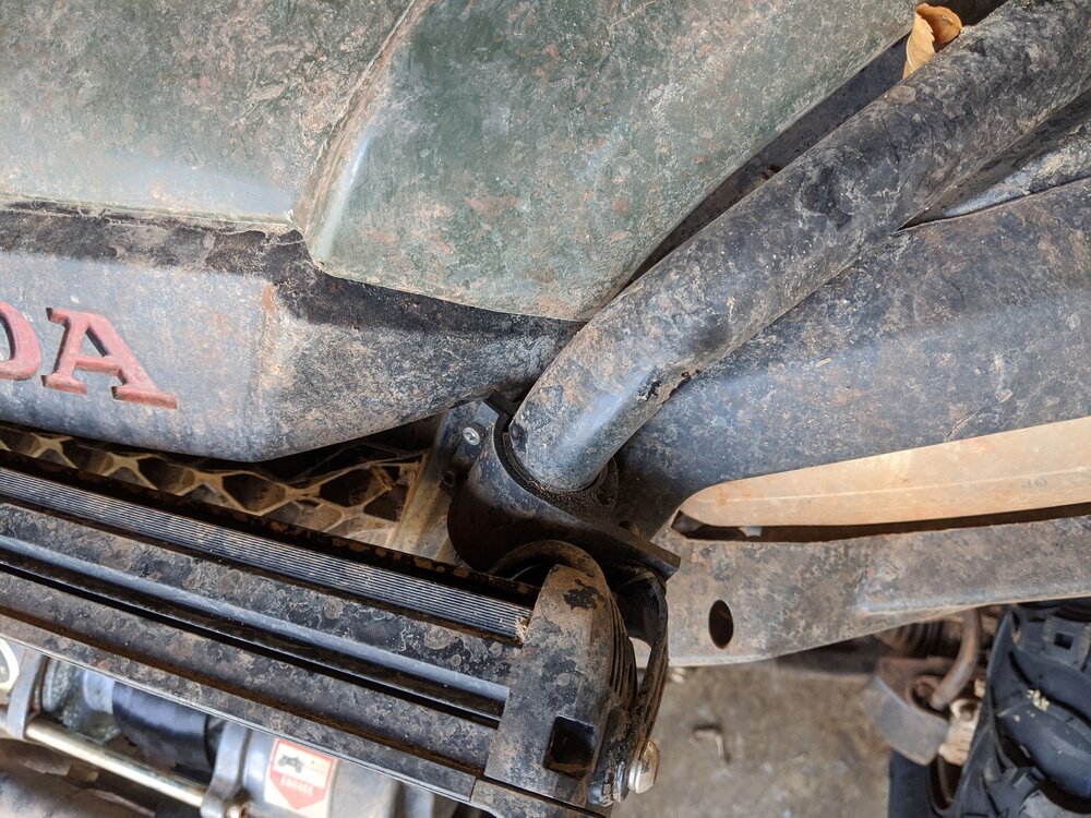

Not sure of the rules for linking everywhere, but search for "GS Power Tube Clamp Bracket", front tube is 1.25" I believe
View attachment 269650View attachment 269651
Yeah, that is what I used as well. The square end (opposite from the mounting location) makes it a tight fit. I ended up unbolting the tubing from the cab frame to give me a little more room to get it positioned and installed. Once installed, I reconnected the tubing to the cab frame.
https://amazon.com/dp/B06XZWYZ65/?tag=sxsweb24-20
