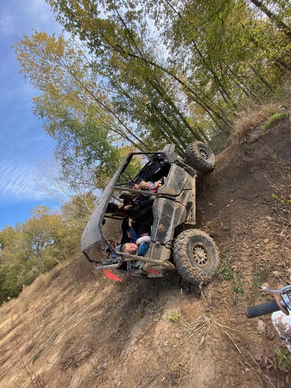

It is the metallic one well was

If the pax side speed sensor gets dented, it's been known to turn your whole world akilter - as shown in your pic.
The speed sensor lets the i4WD know when a wheel is loosing traction and slipping, it then applies braking to the slipping wheel so that power is redirected towards the opposite wheel that has traction. There are arguments about the advantages of i4WD vs. regular diff-lock 4WD. Both work well. But while locked diff locks can cause plowing in loose surface cornering, making steering feel clumsy, i4WD helps pull the front end through those turns - - unless you have a dented speed sensor, then all bets are off.

Well scratch my belly and call me Shirley! I Stand corrected, had know Idea about that part
