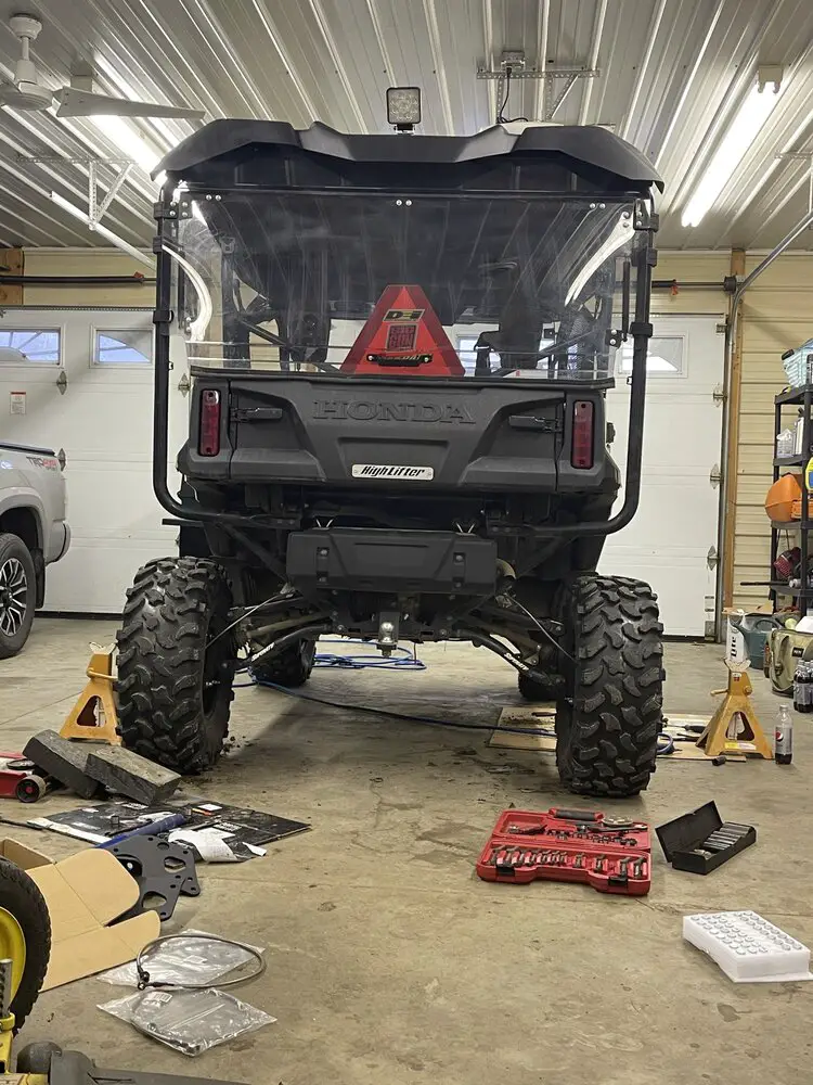

Well here’s my build 4inch portals with 814 shocks supertav arched a arms 1.5 inch wheel spacers swamp donkey stereo super atv heater rear window 30 inch system 3 xtrs doors and mid panel should be here this week and the dynojet tuner
View attachment 239683 View attachment 239684
What is the height of your rid to the top of the roll cage? I am running the forward arched a arms and 32s with 4in portals and have rubbing issues at full turn. Thinking about buying the 814s but was curious if it would add overall height to the machine or just bring the wheels in a bit because I know I'm squatting with the stock shocks.
