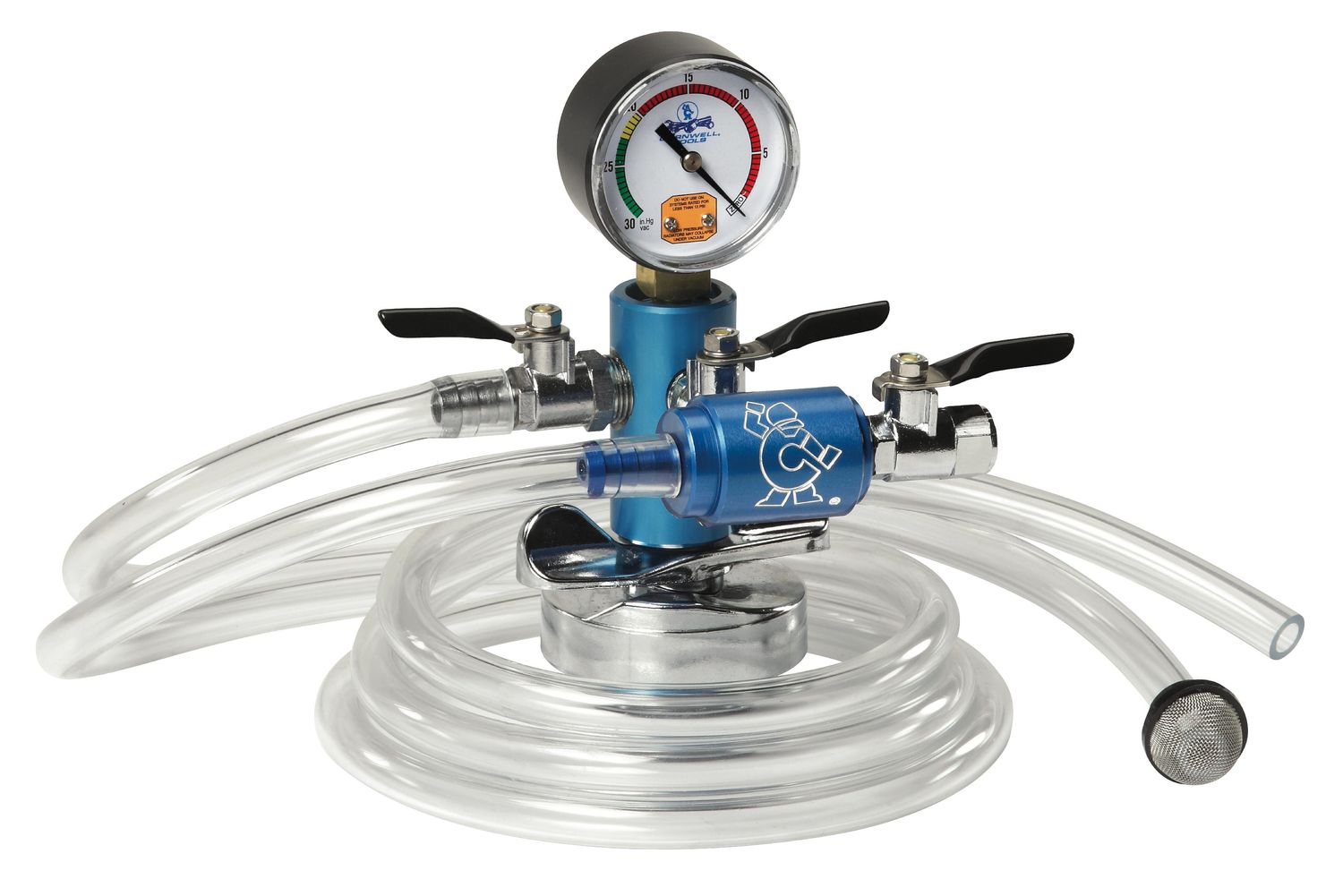

Try a coolant vacuum, I don't mess around trying to burp any more. 5 min and done with vacuum. the tool sucks air out replaces it with coolant. also it will tell u if u have a leak or head gasket blown it won't pull any vacuum if there's a leak
This is the one I have.
