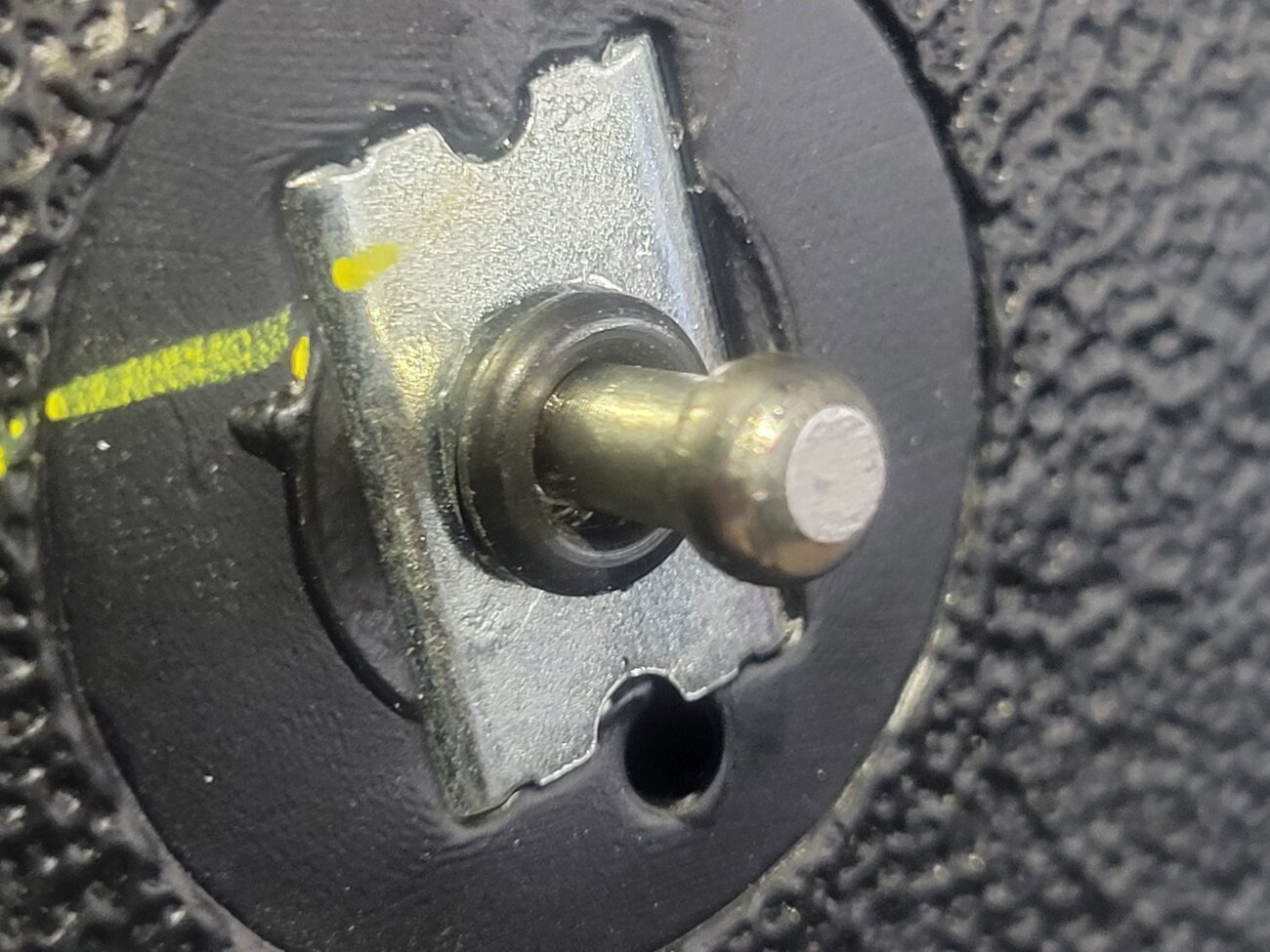

I imagine most failures of the button mechanism would be due to vibration and dirt intrusion. Aside from putting weather strip around the opening, which if done properly will cut down on vibration as well as help keep dirt and moisture out, here's another idea:
Put a small O-ring on each button shaft (a closed cell foam washer would work too, but you'd probably need to make them - I couldn't find suitable ones on line, so used O-rings for now. This helps seals the button mechanism to keep dirt and moisture out and hopefully prevent button failure, and also cuts down on vibration.
I'm doing the door push pin storage mod. Do you think the rubber o rings were worth it? If so, what size inside diameter on the o rings did you go with? 5 mm? 4 mm?

I'll have to check the size of the O-rings, the screws are 6mm, but the area is necked down, so probably 4mm. In retrospect, I think a more easily compressible foam washer would be better for the job, easier to adjust and less likely for dirt intrusion if misadjusted (I had an O-ring protected one fail). So making foam washers is on my to-do list.
