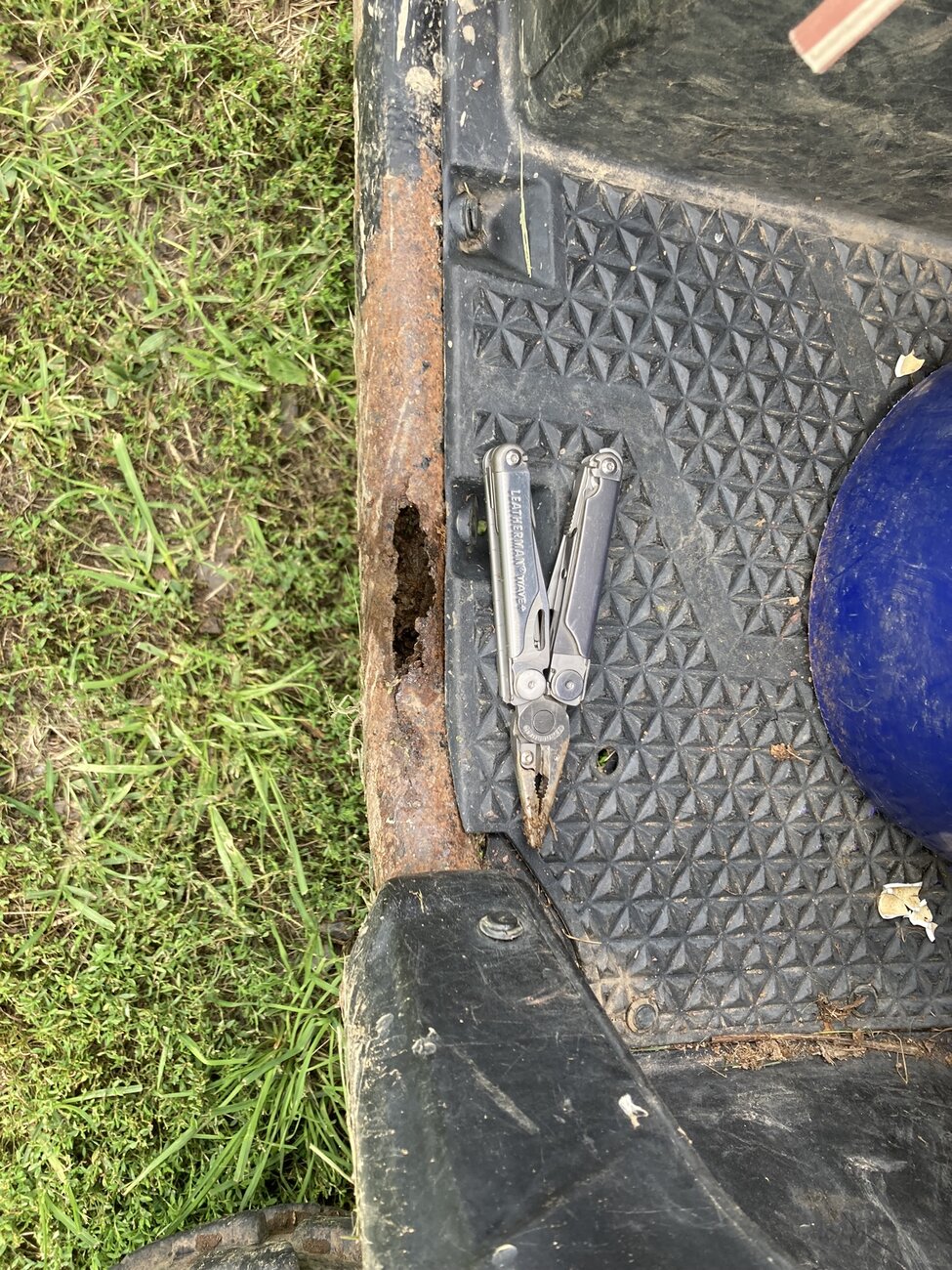

3971E175 1D61 43A8 91A0 7E024D11EABE
Not rust free in pa on my 2015. This is on the passenger side,the drives side has a some surface rust. Bottom of the pipe seems solid.
