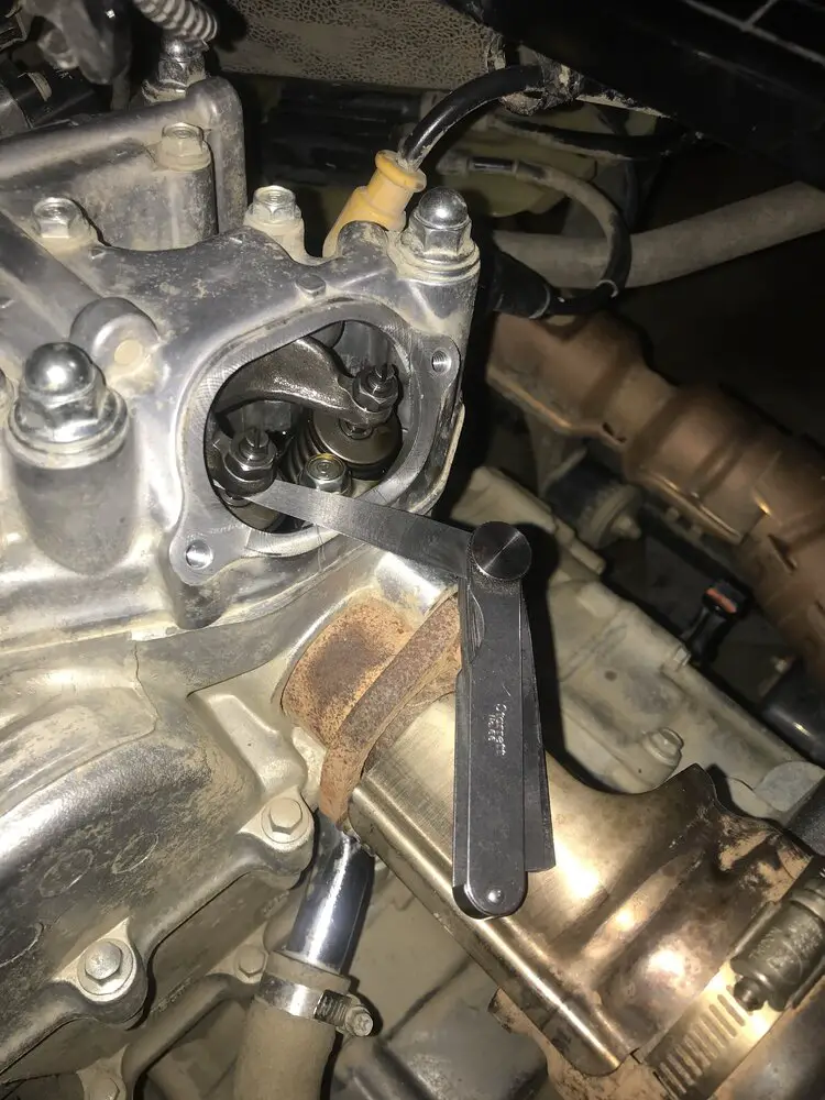

Once in the gap you can adjust the valve tappet but keep in mind it won’t take much at all to get within spec. You only want to feel a little resistance.
Yep, that's the way I did it. Interesting that the intake side was correct at 0.006" gap but the exhaust side was close to the same too. Almost as if the guy at the factory assumed both sides were the same.

Checked them 7hundo valves today and used this guide. I’m at 1700 miles. Valves were in spec but still enjoyable to perform because of this write up. Thank you for your time. 😉

Now we are to the hardest part of describing how to adjust valves, because it can be hard to put into words just what needs to be done here.
Study this picture...
...and you can see what we are trying to adjust here, but there are some pitfalls. We want to measure the gap between the valve tip and the adjusting tappet ( or screw, in this picture ). What we don't want to do is have the "feel" of that gap thrown off because of putting our feeler gauge in at an odd angle due to our access windows. This becomes more likely with thicker feeler gauges, so the exhaust side of the Pioneer can be a little difficult to judge. For this reason, i bend the tip of my feeler gauges a bit to get a good straight angle between the tappet and valve tip.
Select the proper feeler gauge for the valve you are trying to adjust, and try and insert it between the valve and tappet. If its the right size, it may be hard to insert at first, but should move easily after you get it started.
Again, the drag on the feeler can be hard to describe, and honestly, probably varies from person to person. Remember this one tip when it comes to valve adjustments: Unlike most things in life, when it comes to valve clearance, too loose is preferable to too tight. Loose valves ( within reason ) are likely to only make noise ( this is not a license to run way loose valves, BTW ). Tight valves are more likely to cause serious engine damage and performance issues.
Now, the best way I've heard the proper feeler drag described is to imagine pulling a sheet of paper out of a thick dictionary. The FSM also offers the tip of judging the drag while pulling the gauge, not pushing. If you get a light drag on the gauge, then you are lucky, and no adjustment is needed. Repeat for the other valves. If they are the same, button the machine back up and go buy a lotto ticket.
If the feeler gauge cannot be inserted, has a ton of drag or none at all, you are going to have to adjust the clearance. This is done by loosening the lock-nut and rotating the tappet with a flat screwdriver...
...If you are doing the intakes, you might want to unplug the fuel injector harness, since it takes up real estate that the wrench wants to occupy, and you don't want to break it off. Remember to plug this back up before turning the key on, or you'll get a code...
Remove your feeler gauges while adjusting the tappet screw, as you don't want to dimple them. Unfortunately, there is no hard and fast rule to doing this, and it doesn't take much of a turn to change the gap pretty significantly. Furthermore, tightening the lock-nut ( even while holding the tappet ) also changes the clearance minutely. Trial and error are really the only way to get this right, but you will quickly catch on...
Turn tappet, then snug down the lock-nut with a wrench. Re-check, until proper feel is obtained. It may take many tries to get it right...
Once you get the right feel, move on to any others that might need to be done.
