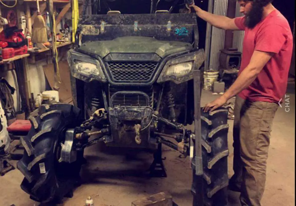

Btw, P700-4 upper balljoints are not the answer. I guess i gotta get one of those reamers. Thats funny considering these are made for the 700-4 and the 700-4 balljoints wont go in. I wonder if they changed balljoint size from one year to the next and utvsolutions welded in the wrong balljoint bungs? Oh well.

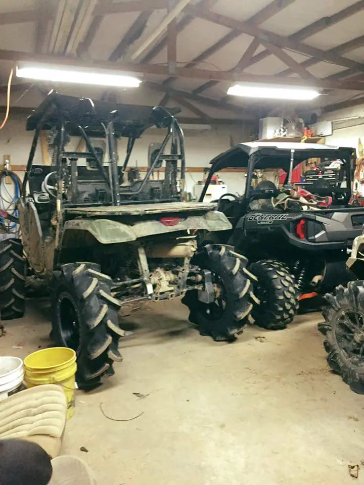

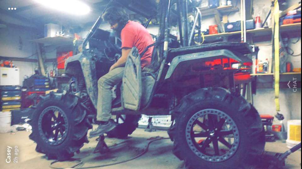

@Bastardchild started a new craze , this one is on facebook!
View attachment 67995 View attachment 67996 View attachment 67997
Haha! Yeah Choogs me and him have been texting back and forth on and off all morning. I told him about hondasxs.com and i told him about the Pioneer Takeover. He said he'll try to see if he can make it. I told him it would be cool to have 2 P500s on portals at the takeover. Maybe he'll become a member. He seems like a nice guy. He's a welder by trade, so i bet hes got all kinds of mods up his sleeves he could share. Thanks for the shoutout @Chooglin! :) btw, he's running 35's also!
