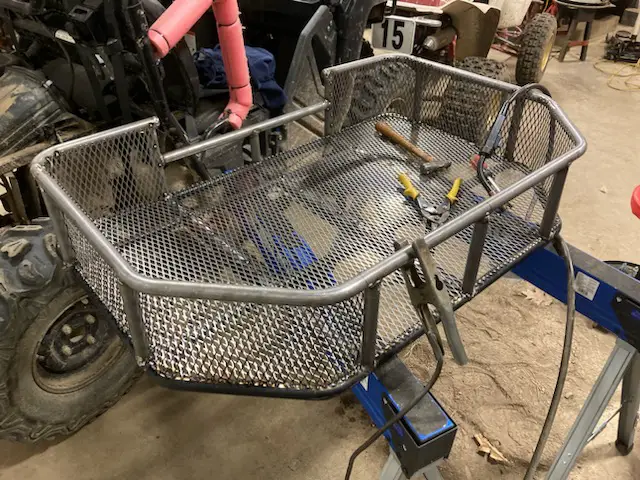

So, finally forcing myself to "hurry-up" and get this long over-due project finished: modding the rear rack on my P500 into a basket rack:
The start-
IMG 4340
Remove the rear rack and fenders - wow! that is quite the air intake muffler!
IMG 4342
Rack on the floor for measuring and use as a template
IMG 4343
First bend in the matching 1" tubing that I am making a "copy" of the OE rack outer perimeter
IMG 4350
Making the last bend to close the loop
IMG 4354
All bent with the end seam welded.
Next step is to finish cutting all the up-right supports and welding to the OE rack. I then plan to put metal mesh on the "floor" of the rack and around the sides.

Week-end update:
I had about 4 hours to work on this over the weekend and I got this far after 3 hrs. of cutting and notching the vertical tubes. I tacked it together and did a test fit.
14  rack tacked together for test fit
Oops! Should have put everything on the machine then tacked it:
16  rack mounting holes do not line up
That's up against the R.O.P.S. - mounting holes do not line up! Well, cut it apart and try again......
MI-Trailblazer
MI-Trailblazer
Apr 4, 2019
305
1,508
Parma, MI
Fixed my problem last night- the "V"-shaped bar on the back of the R.O.P.S. sticks out further than the rest of the R.O.P.S. and my 8-inch higher rack top rail ran into that bar. So I altered the design last night:
17  Altered design of rack
It's not as pretty as I would like- rushing this project because I need to use the P5 this Friday for racecourse set up for the first quad race of the season.
