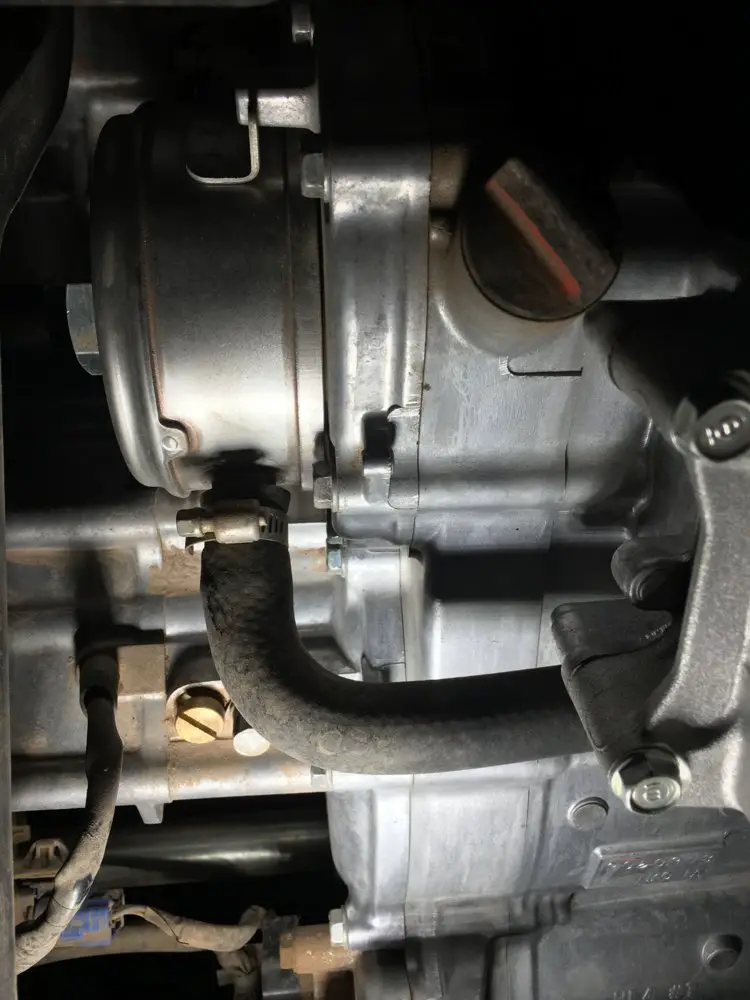

Here is pic of top of engine.
The black hose coming from the oil cooler is covering the only thing I need to verify the updated cover.
Look and see if there rounded bump right next to that bolt head. If there is, the update has been installed. I've uploaded a picture of what you'll be looking for.

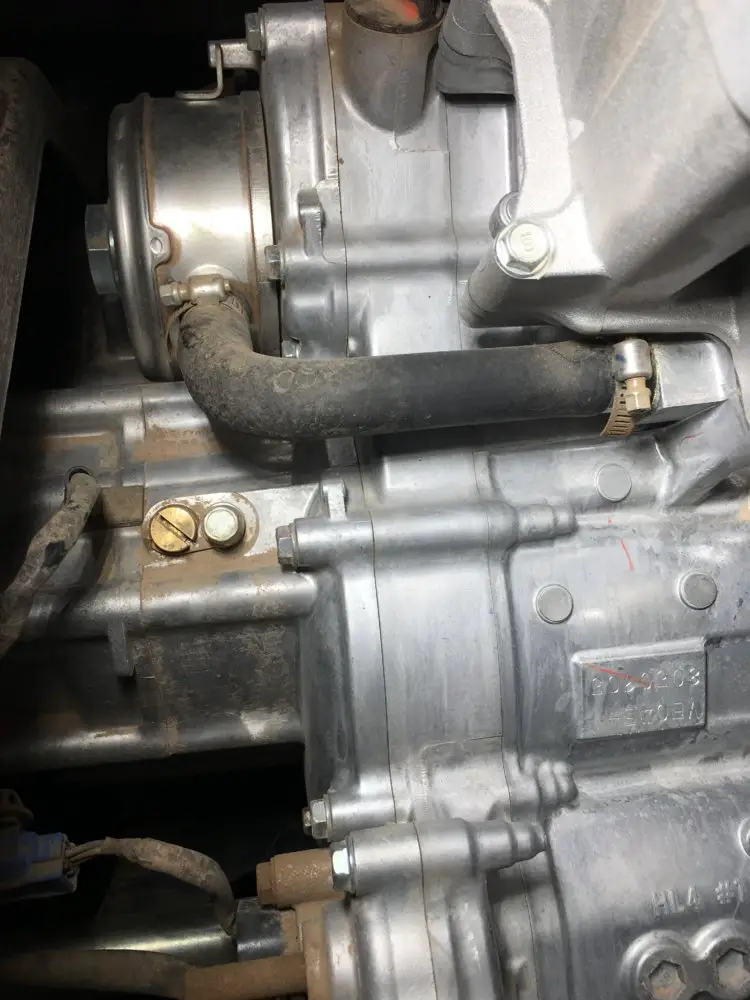

thanks for reply. Looks like I need update. I only have 450 miles. Should I put more miles on or take it in ASAP?
The clutch update will changed the way the machine feels. I would do it as soon as you could, but if the clutch were to go out Honda would cover it regardless. It's just more work and would have your machine down for longer.
