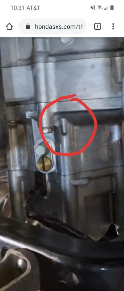

So thanks to this forum, and all the great input, I ordered all the parts and did the clutch change out and added the new upgraded plate myself. Everything went fine...no leaks...works great except for one thing, when its all warmed up and I'm on a down hill angle, I get an oil light on the dash sometimes. I've triple checked my oil level hot and cold. (Not screwed in but just resting in the hole) Its perfect. I go to level ground, shut it off for 2 seconds and its fine and light goes off. Level ground and high speeds, its all good. I also want to say I'm not doing big off-roading. I work cattle so if I go to a pasture where there's a slight incline to get out and open a gate, that's when I notice it. Suggestions?

Does it ever shut off when the oil pressure light illuminates?
Id pull the emergency valve piston, id bet its scarred up ans sticking.
Nope. I just see the idiot light come on...never shuts down.
I have to buy the book on this thing. It may be as when the first clutch burned up, it was pretty dirty. Can you point me to where its located?
