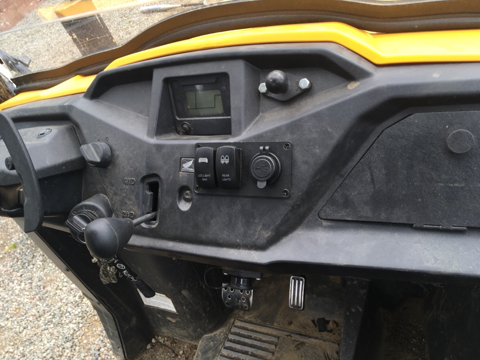

Installed front and rear light on bike for snowplowing. Here in Labrador Canada we have already set a record for snowfall for this date. We already had 168.2 cms of snow fall, or 5.5 feet.
Anyways, I bought a plate made for 3 switch’s. Front light, rear light, USB charger.
E3079a6462284f80dd76424722ec2ce1
What I’m looking for is a wire that only has power when the key is ahead or bike is started.
The switch’s light up and power for the USB only if key is on.
Thanks whoever can help

Just to add to this, I have both lights working off the switches, just need a wire that only has power when key ahead/running for the switch itself to light and USB... sorry not to be confusing

The Honda accessory harness simply plugs into a connector located under the hood. This will give you four connections for key-on power. They label what each is for, winch, horn, etc, but it really doesn't matter what you use them for.
P500 - Accessorry sub harness description
Thanks for this. Any wire without this harness ?
