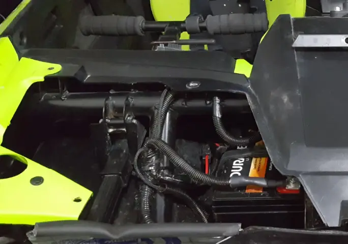

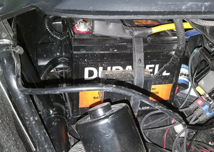

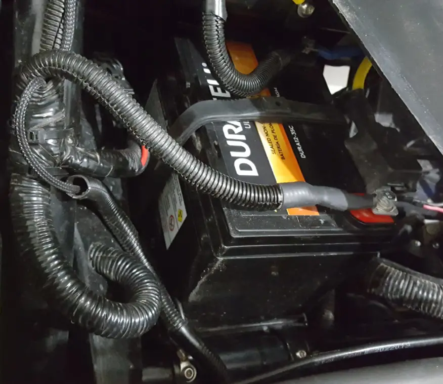

Pics as requested...

Thanks, Paul. 👍 I have that panel removed to install my Ryco turn signal/horn kit - dang, there's a LOT of room in there. :eek:
Yes, there is a lot of room. However, be forewarned that putting the battery (or anything for that matter) back there does have its drawbacks if you have the storage box (or build a firewall like I did)...
  1. If you build a firewall and/or put the storage box in, the access is bad and you may have to remove the cowling/panel to get to it.
  2. If you plan on needing access to jump start someone, you will need to add a quick connect for jumper cables.
  3. You will need to put any extra fuse/relay items somewhere else. If you put it back there with the battery, it will make testing/changing fuses extremely difficult.
To avoid these drawbacks, I did the following...
  1. Nothing I can do but I did use high quality materials, marine heat shrink and a circuit breaker for the winch to reduce the possibility of needing access. So far, everything has been flawless but time is never kind on electrical connections in harsh environments like this.
  2. I added cables from the battery to the storage box with a "Quick Connect" and then cut off the clamps off one end of my jumper cables and put another connector on the jumper cables. All I have to do is plug them in if I need to jump start someone (or myself).
  3. I put a fuse/relay box in the glove box. It stays dry, keeps my fuses and relays all nice and tidy and is easy access if I need to change a fuse or relay. Took up a little of the glove box but it was worth it to me.
