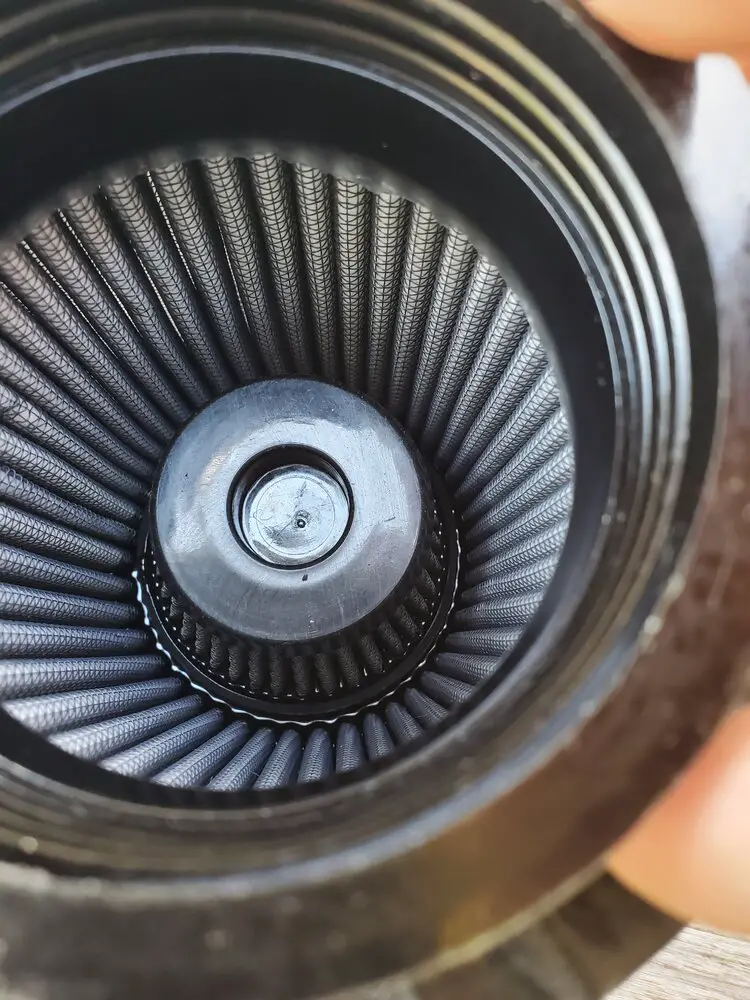

I would say the prefilter is a great idea, especially if you can see it like the one above everytime you walk around yoir machine.

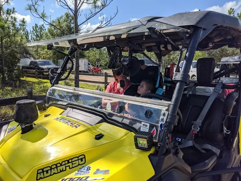

Exactly why I have a prefilter, I can easily check its condition and R&R quickly (I have a spare ready to go). A lot of guys are hesitant about cutting a 3" hole in a body panel but I got over it when I weighed the advantages.
1628862387368
Doing its job and the stock filter is still spotless -

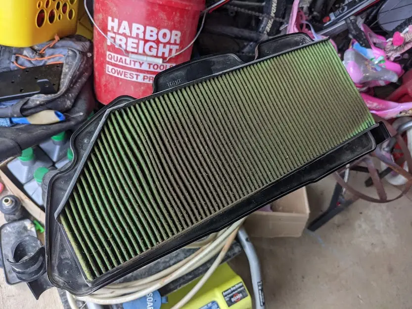

This was my stock filter at close to 2k miles, not bad at all

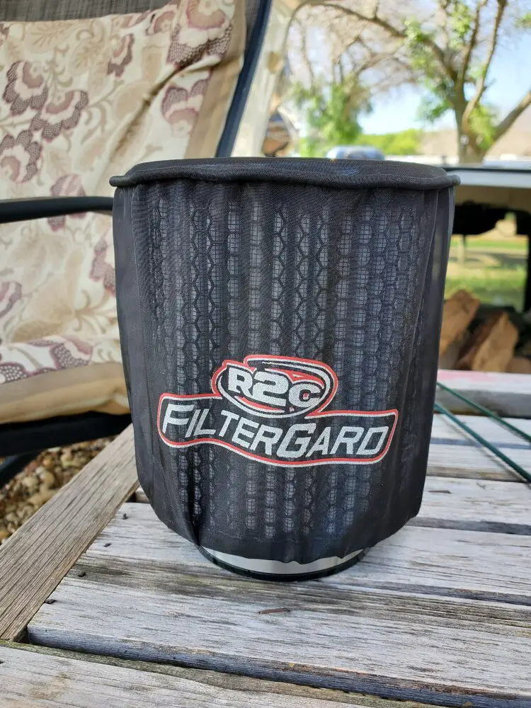

10-80 Dirt Sports sells a universal R2C prefilter along with an optional outerwears style cover. It fits a 3"OD tube and comes with a clamp. It's a non-oiled style filter with a semi open element that doesn't restrict flow to the main filter like using a K&N or other "air filter" will.
After every race I take the pre filter off, tap the dust out and rinse the outwear sock in the sink. Easy peasy
