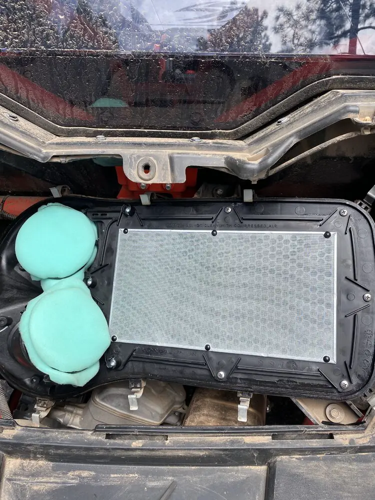

That seems like an excessive amount of filtering and probably hurts your horsepower and torque numbers some.
The green UNI foam isn’t all that dense. But I like the peace of mind of a fail safe system here. Took it for a spin yesterday, 10 miles pulling a 1,000 lb. trailer. Did just fine…👍
I have been running the green foam over the tubes ever since I installed my r2c and I find no HP loss that I can feel in the seat of my pants. I originally used the green foam as a test to see if any dirt got past the r2c media and then got caught in the oiled foam. After intentionally riding miles behind my son n laws UTV eating all the dust I can endure I found the green to be free of any noticeable fine dirt even after washing the foam in a clear container and letting anything settle to the bottom.
Word of caution Montecresto,,, Make sure your wire ties are zipped up good since the fit around the air horn is like it is. I found one had come off and was laying in the air box at the bottom and the foam was just resting on the intake tube. I now secure the wire tie by running a tie under the one around the tube and running that one thru the clamp screw on the side of air horn. That way if the tie comes off it will just dangle and not risk going down the tube and blocking open the throttle plate.
BTW smear water proof (Belray) grease around the sealing edge or your air box and you will have a fail safe dirt proof seal. Kinda messy but not a big deal at all... When you service the air box it will stick on there and you will half to tug to get it off. Clean off the old grease using mineral spirits with a pair of your wife/GFs old panties and re apply new grease and yer good to go. I do not remove my lid too often because I have a "Filter Minder" installed and it tells me when I have restriction and cleaning is needed.
Yep, figured that one out before I ever reassembled the box. Made adjustments and took it on a small 5 mile run, checked it again, then an all day 70 mile run and checked it again. Just got off a 7 day cross country 500 mile run and anxiously await opening the box to see what I find…
