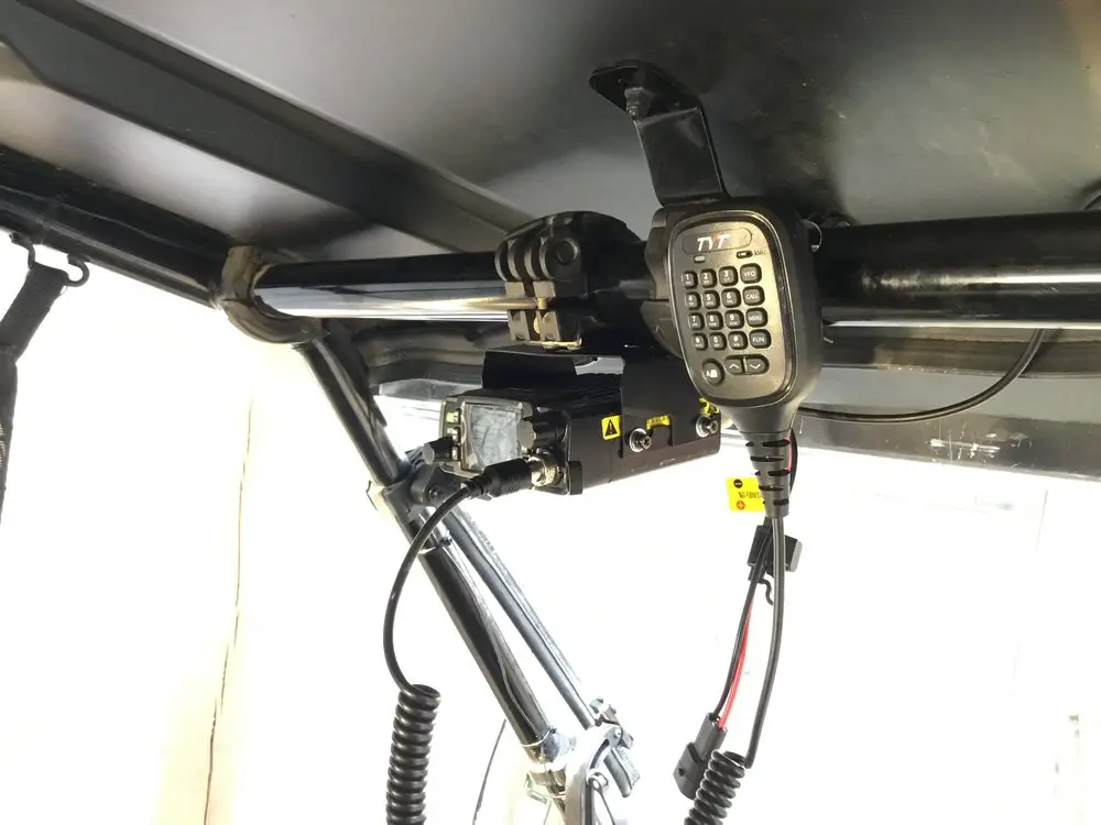

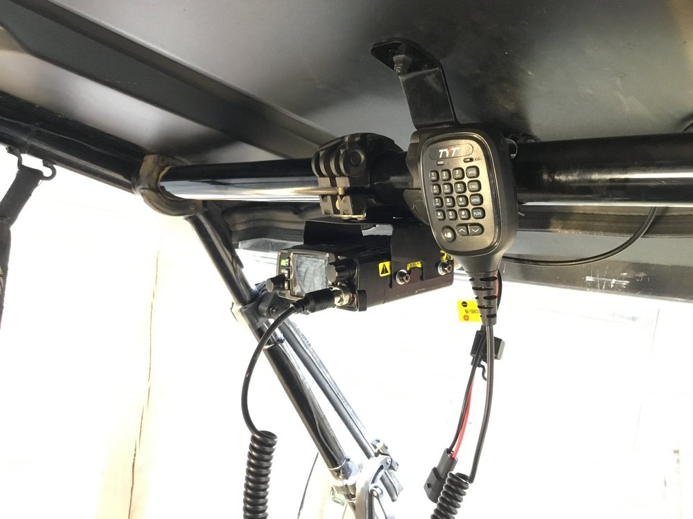

BikeBandit had ROP OEM quick clamps if that helps. Mounted 2 way radio. 41.3MM dia tube (1 and 5/8 inch diameter - approx). Think of similar to rear view or side pillar mirror.

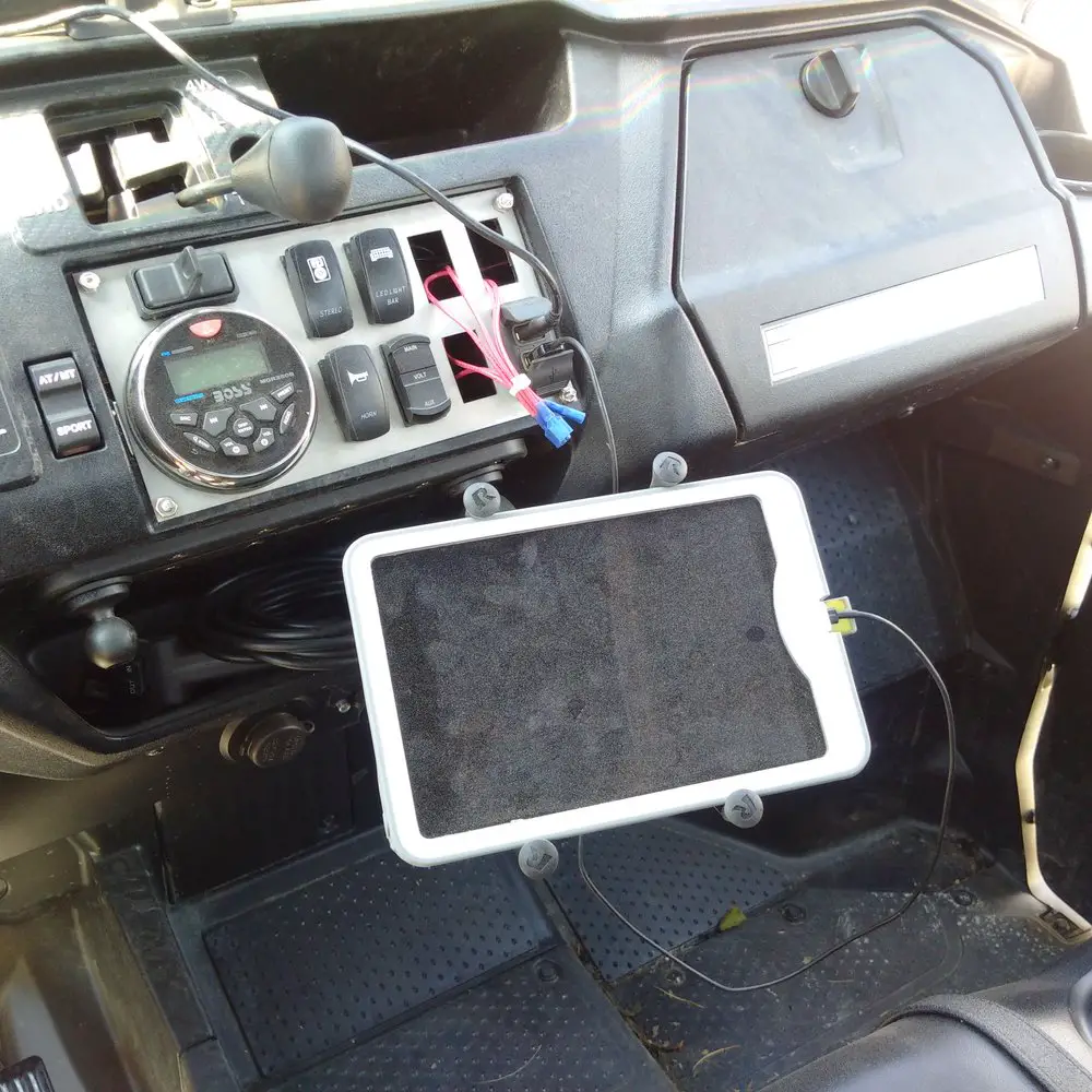

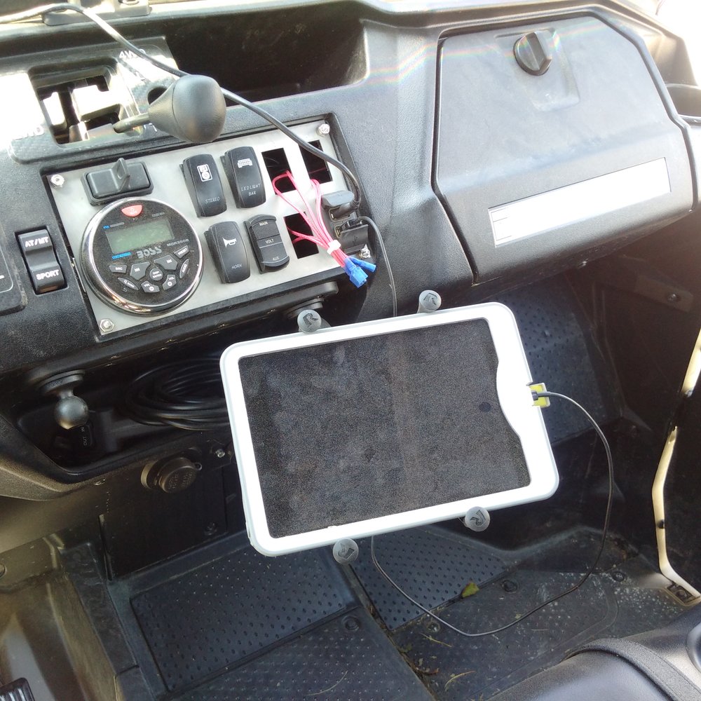

This is how I have my ipad mounted. I would suggest a better attachment than the X grip I used. I am not impressed with it. I have a new tablet to install over the winter. It will be in the same location, but uses a locking dock from Ram. It will charge as soon as you place it in the dock.
Yep, that's what I'm looking to see. Think that location will work fine for my P-5. Is the x grip what is holding the tablet?....or is it the mount on the dash? That looks like a great setup, like that it is near the 12v outlet too. Any idea which locking dock from Ram you are considering?....any clues here are greatly appreciated!!

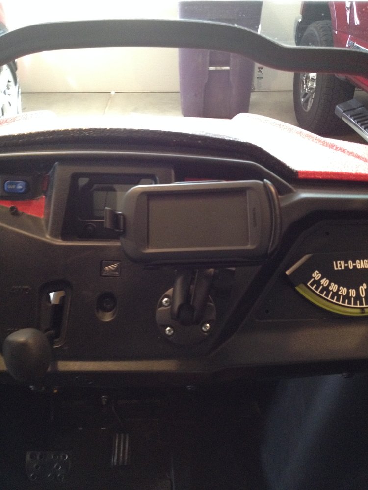

IMG 0807 The magnetic attached mount connected to the ball works really well, easy on and off and quick when changing devices, from cell phone to iPad, etc,. It's what we use in our utility Helicopters, and on my Honda Foreman and P500.

I will see if I have all the components here at camp this weekend to mock up a picture for you. Nothing wrong with the X grip, I just don't care for it for this application.
Hit up amazon and look up "ram track" see if you can mount a piece on your dash. You can add a cup holder for your passenger, or some other ram accessory to make your ride better.
