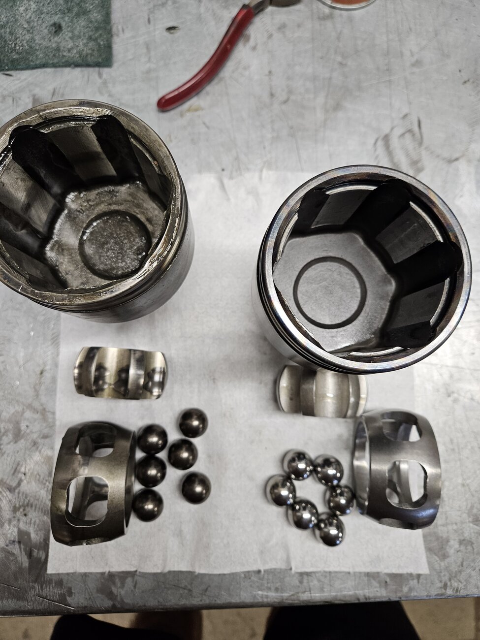

Replacing a noisy CV Joint. Picture of stock Honda axle that had 5000 miles on it with out any problem or noise. Then went to ST got ripped of on springs and they added 1 1/2" of ride height. This is where all started. As I have went through about ever axle out there and have the pill to show it. The Honda axles are the best out there hands down. It is when you start adding more angle to them that you will get the noise. 20 degrees + a couple but if you get to 25 degrees that is too much. Find somewhere you can run hard for about 20min. then check temp of the inside CV. I saw 347degrees. In the picture hard to see the outer race has the same 1/8" groves. Just my thoughts.

Always set ride height and don't increase the angle of your axels. At full droop the axels should be ok because there not there very long.
