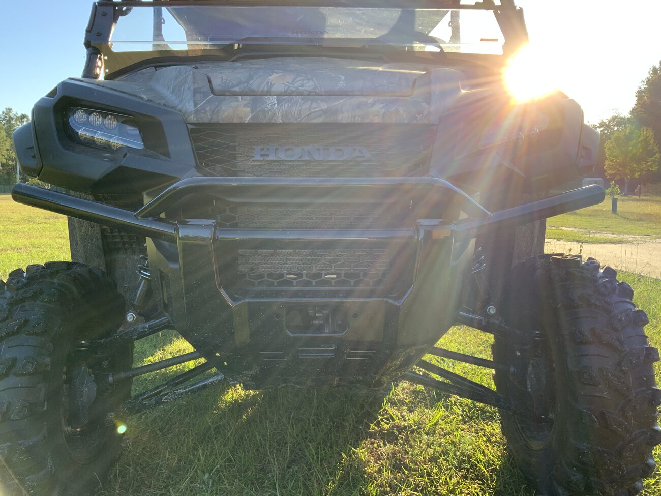

I'd recommend a minimum of a 4500 for the P1k. 3500 would be fine, but just for peace of mind...4500. I can get you a discount on ours if you're interested.

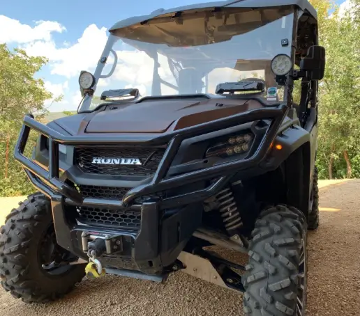

I think you can keep your stock brush guard, but my experience is with a P1K1000-LE.
I bought a KFI mount, which is inverted to have the cable spool over the top. Inverted reduces the angle through the fairlead rollers to reduce wear on the wire/rope. The fairlead bolts through the brush guard to a backplate that comes with the mount.
It was very easy to install, did it all solo, and I didn't have any trouble putting the brushguard back on myself. There are stories on other threads where people struggled to get the brush guards back on.
This is it. The fairlead bolted onto the stock brushguard and you can easily reach the freewheel release around the left side. You can also see the snowplow mount underneath. Most of my use has been to lift the plow, but I've recovered a stuck SxS and it was good to have the 4,500# pull. We anchored my machine and dragged a razor up hill. (Eternal truth: Honda tows Polaris).
I found the link to the mount and it looks like this will cover you. It was very easy to install.
i have the 1000-5 delux, so its a different brush gaurd than the LE. But it has the square cut out at the bottom like yours, so it should work the same, correct?
Yes, that's the square cut that I had. KFI lists your Deluxe as a fit.
KFI also has a specific list of 50+ compatible winches with this mount, but also states:
  • Possibly many others with the below standard mounting patterns, call to confirm.
    • 4-Hole (3.00" x 4.875" bolt pattern with rollers that are 4.875" bolt pattern)
    • 4-Hole WIDE (3.00" x 6.60" bolt pattern with rollers that are 6.600" or 6.000" bolt pattern)
    • 2-Hole (3.10" with rollers that are 4.875" bolt pattern)
The fairlead and brush guard backplate aren't the issue with this part, it's whether the winch base will fit the KFI mount.
Gives you a lot of options and they say to call if you have a specific question.
I didn't explain before, but my first SxS was a Teryx 4 that I had for 6 years. I had a Superwinch Terra 35 on a KFI mount and it worked great - both the mount and the winch.
