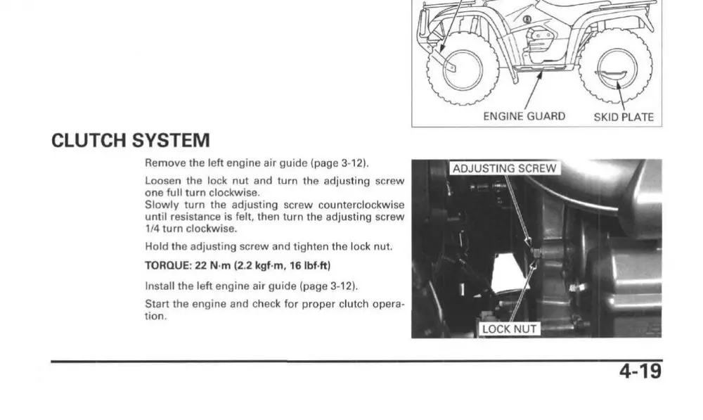

This is the procedure for the clutch adjustment. I have found that it shifts best , if you go a little more than the 1/4 turn !
IMG 0971
When you put the cover back on the oil filter , DO NOT OVER TIGHTEN THEM , some have snapped these bolt trying to tighten them to much !

Thanks for help. New Honda synthetic oil. Adjusted the clutch. So far it's a noticeable difference. Shifts smoother for sure. I guess it could be a combination of both new synthetic oil and clutch adjustment. Hitting the trail tomorrow.

So after some concern with the specs of the Redline oil I decided not to use. On one of the bottles I read an area where is said, use for JASO MB. Well I know the Honda recommends MA and not MB. I returned the oil today. Well once I looked better the Redline was in fact JASO MA. I did a whole lot of running around for synthetic oil and I had oil I could have used all along. Oh well maybe next oil change I will give the Redline oil a try.
On a good note the P500 is shifting way better. Our ride in the woods went well.
