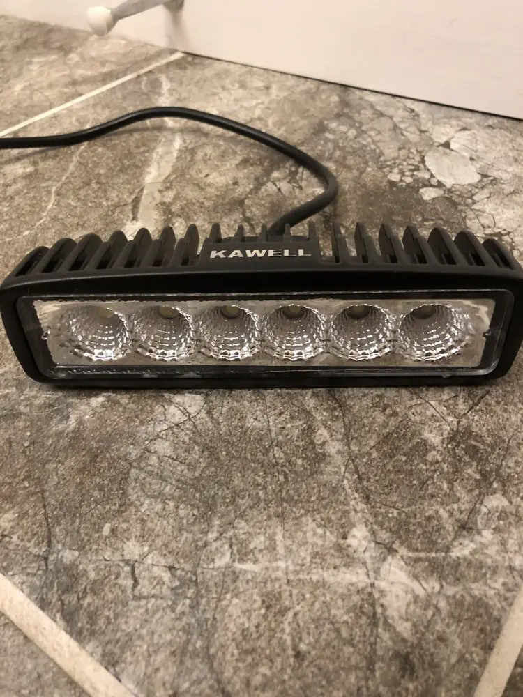

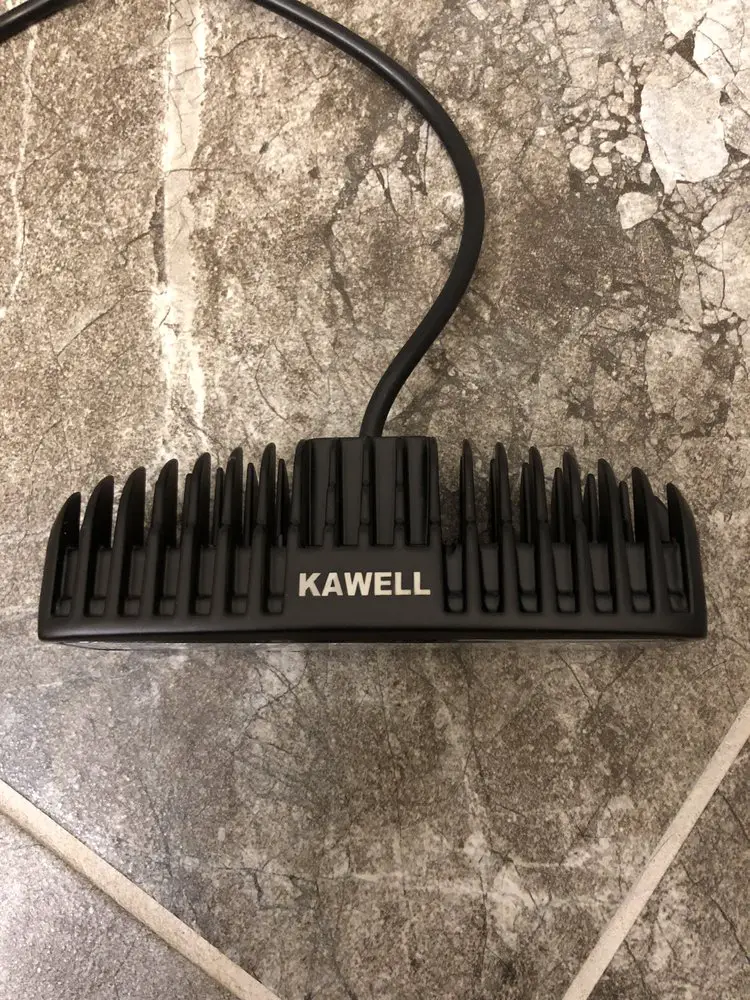

Sorry haven’t ben on here much, ben busy with work this past winter and one of my labs “Gunny” had TPLO surgery. For those of you in ReoLinda that’s ACL aka the “knee” that he blew out around Christmas. 8 week recovery time and were on 5-1/2 and he’s starting to use it more and more! Anyone who’s met my boys @trigger is one that has, knows he’s my shadow and crazy man like his old man lol. So....today I got a part in that I was looking to do way back but never took the time to get it. Thanks to @GlockMeister for the idea! It’s some reverse lights.

Glad that your friend is coming along well. Let's see some pictures of those lights installed.
Plan on it sometime tomorrow hopefully. I’m off work for a few days and some stuff is a gettin done!;)

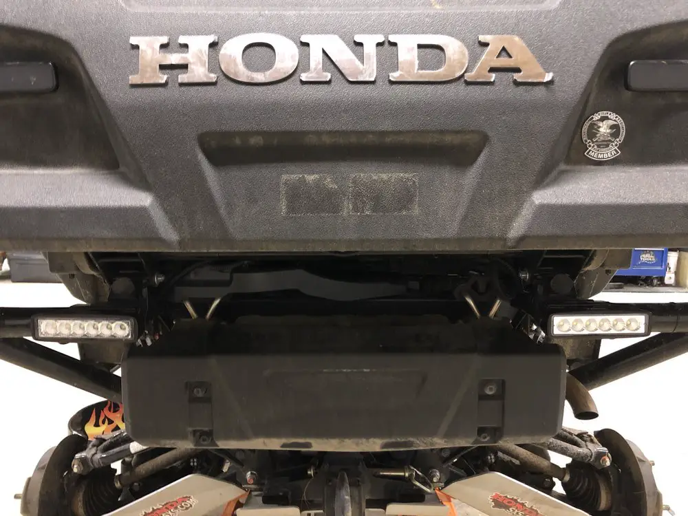

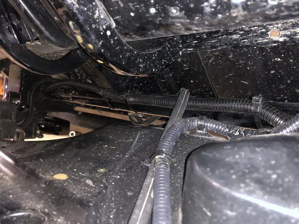

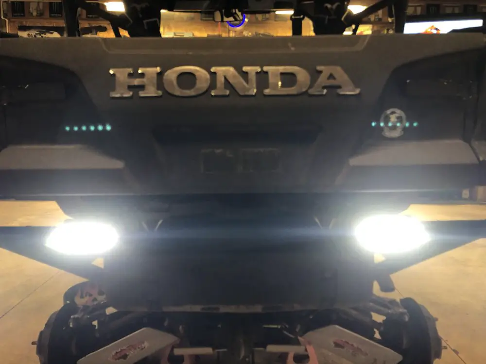

Here they are all wired up! Was a bit of a bear to get the side mounting screws in . I used a little bit of grease on the nuts to keep them inside the light cuz u can’t put your fingers in to hold them. Otherwise all went well there. I used the reverse alarm harness near the oil filters that everyone was using to connect the lights. They only come on when I’m in reverse just like my truck. I have done auxiliary lights on my ROPES up top if I need lights by themselves. I call them “deer gutting lights” lol.

View attachment 68006 View attachment 68007 View attachment 68008 View attachment 68009 Here they are all wired up! Was a bit of a bear to get the side mounting screws in . I used a little bit of grease on the nuts to keep them inside the light cuz u can’t put your fingers in to hold them. Otherwise all went well there. I used the reverse alarm harness near the oil filters that everyone was using to connect the lights. They only come on when I’m in reverse just like my truck. I have done auxiliary lights on my ROPES up top if I need lights by themselves. I call them “deer gutting lights” lol.
Looks good bud! Yeah ..those outside screw are a PITA to get in.
Yes tell me about it! I was bickering so much that one of my dogs went to the side door of the barn and wanted out lol. It was all good though and worth it In the end
