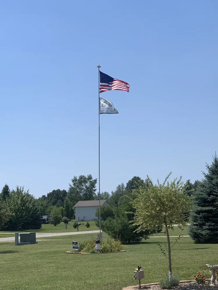

On the BS note...I built/welded a new military style flag pole out of 1-1/4” pipe and put 4 heavy coats of rustolium aluminum on her. She sits at 30’ now.
replaces my old 20’ aluminum telescoping pole that got slightly bent during a storm and was actually 17’ tall in order to get her set in the ground right.

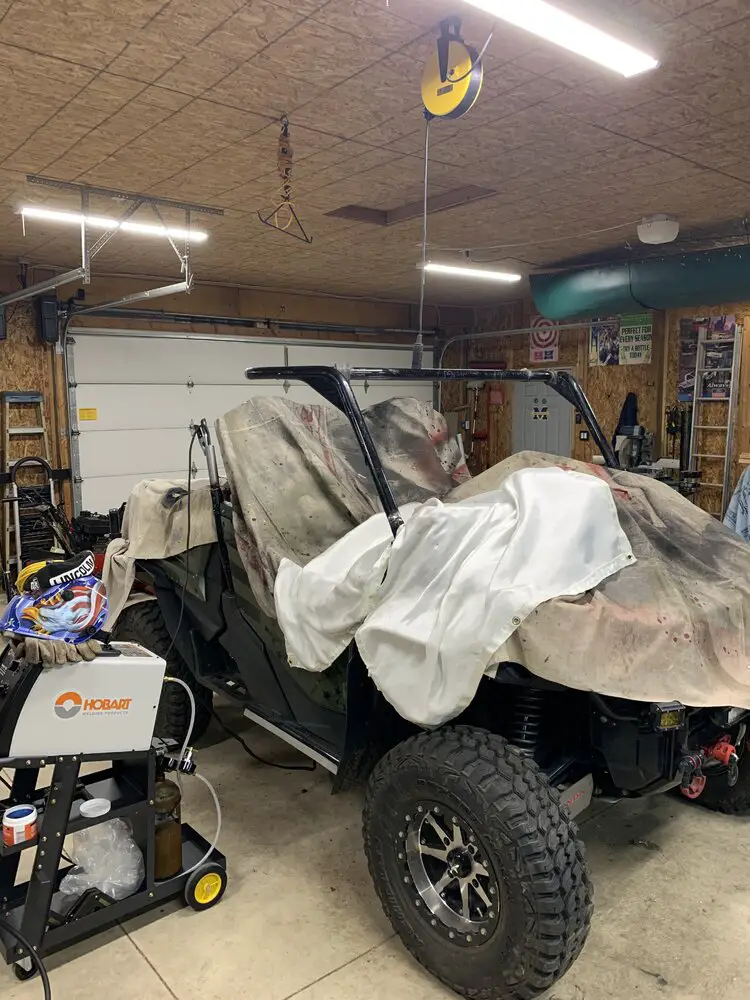

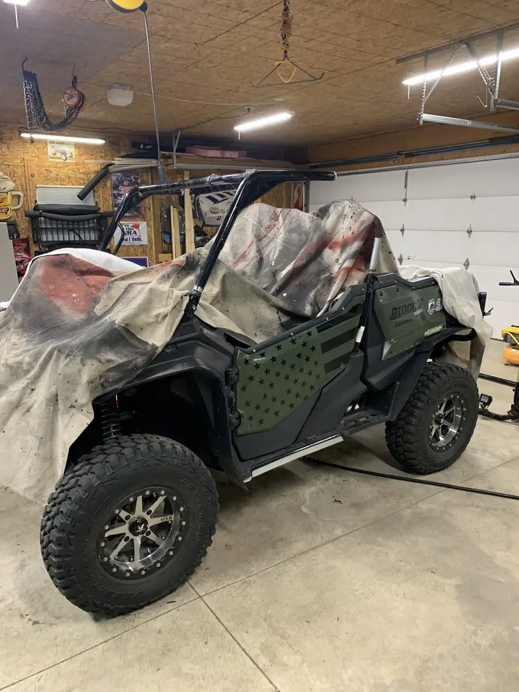

Well smellers! Thought it was time to blow the dust if this ole thread. Decided yesterday to start my long awaited chop top. Two good things about this is the shortening of the paddy wagon style top for a more sleek look and not so tight in my toyhauler lol. The other positive is all the wiring i had under that roof! Whoa!!! Kiss my dimpled aunt that was a mouse nest of the last 5-1/2 yrs. great time to clean that chit up. Special thanks to my good friend @joeymt33 with the plans and pointers he and @snuffnwhisky did to his.
Im far from done but thought id share some pics with yall and dietail the progress

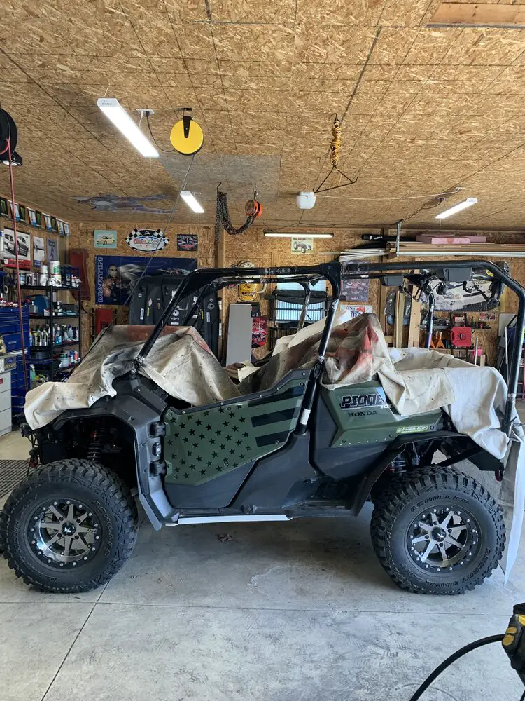

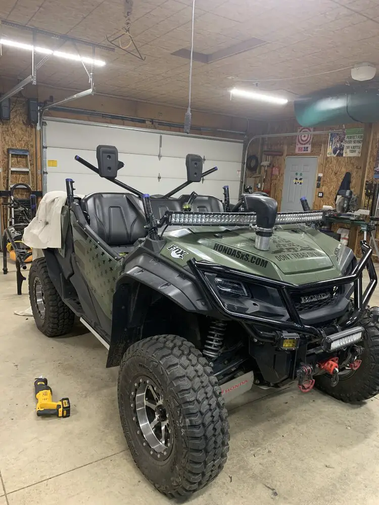

Well heres some pics of the front part partially back on. I like the hight. Its deff shorter at 4-1/2” shorter but @ 6’-2” Ill still have pleanty of head room.

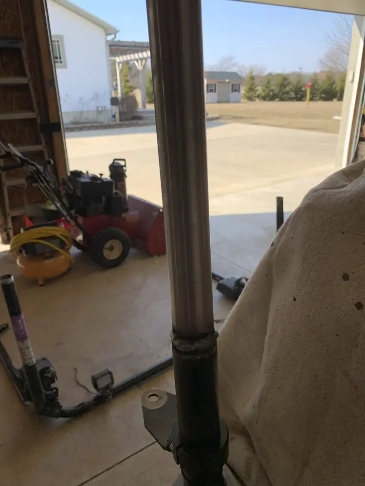

What size 1.5" dom?
That is correct. 120 gauge.
the rears are 1-5/8 120 gauge and im having them Laved down to fit inside the pipe. Hope to gave them back by this weekend.
View attachment 258408 View attachment 258410
I'm about to do mine here in next two weeks. Was thinking 4" in front and 5" in back to level the roof line a bit. My only concern is having enough room on the SATV split windshield as I have to cut that down and doesn't seem to have much room past about 3.5" for the brackets. Do you have a windshield you're cutting down as well?
Yes the SATV flip. Im not 100% sure how im going to do that? But @Plumber32 cut his down and showed me on a ride we were on. Ill be hitting him up on that when im ready to cut it down

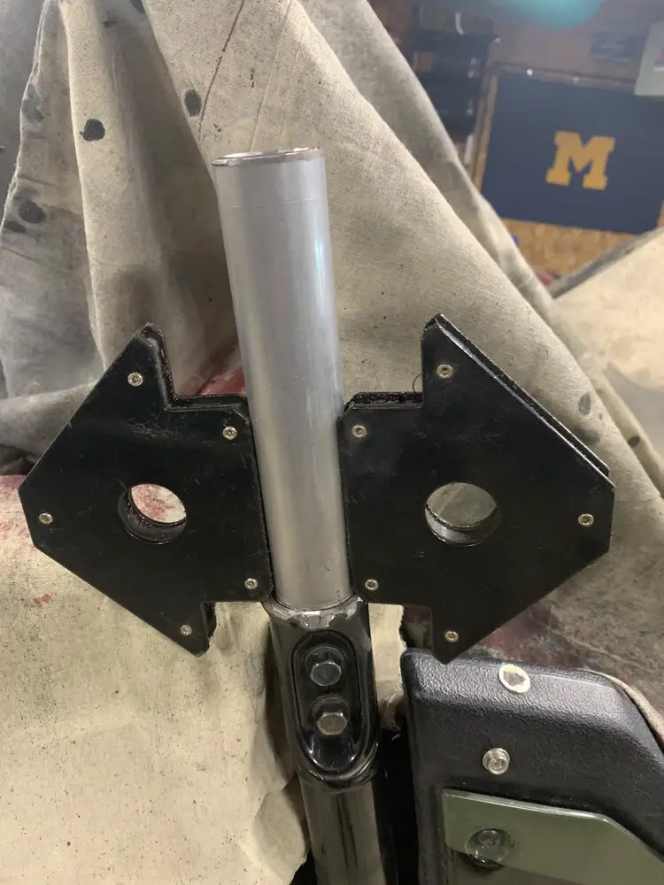

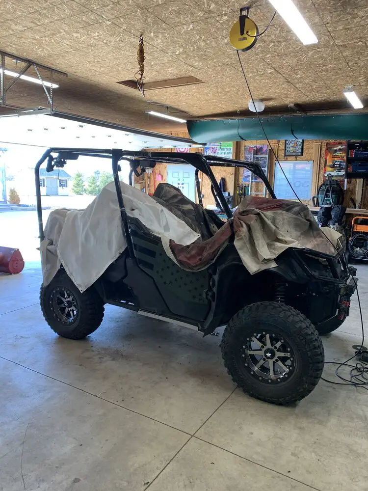

Back at it today. Got the rear pipes back that I had Laved down to a snug fit inside the rear cage. Got the cage on bolted and welded in place. Its definitely stronger than before.

Looking good there feller did you have to add some on the front section of the cage I had to add I think 1-3/4" to mine to get it
to line up with out forcing it to get the bolts back in I never done the rear it was taken off when new and never went back on I posted several pics when I done mine
