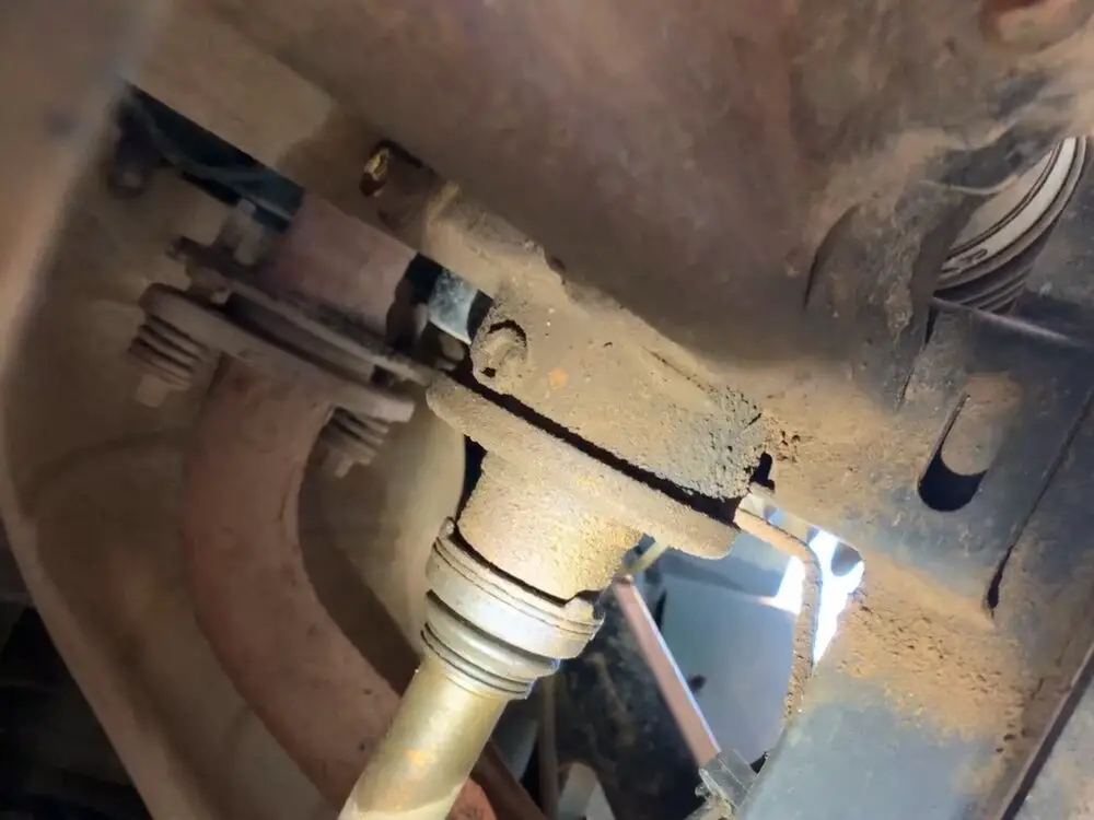

My front seal was leaking as I found a drip on the bottom of the sub-trans. It was under warranty, dealer found the leak to be the seal and replaced it. It was only making an oily mess when the wind blew it onto the skid plate but it was sooooo minor, the level did not go down when I checked it. Out of warranty, I may have just topped the sub-trans off and not worried about it.
