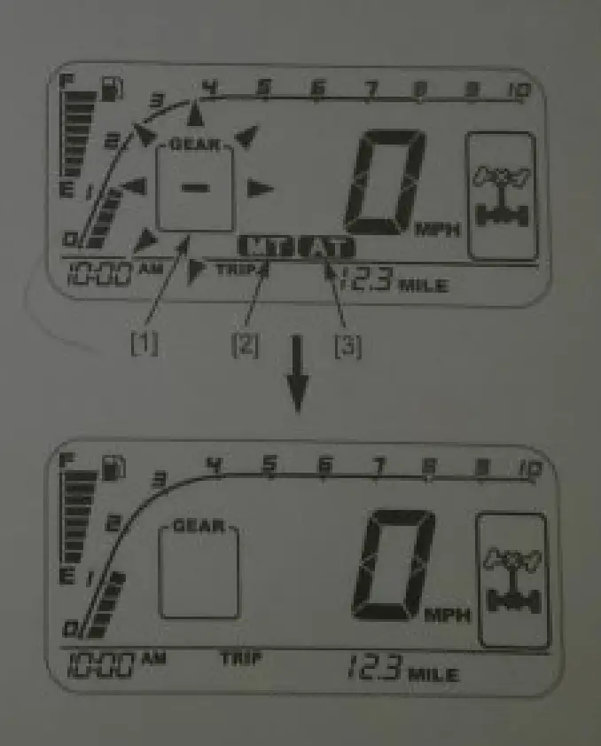

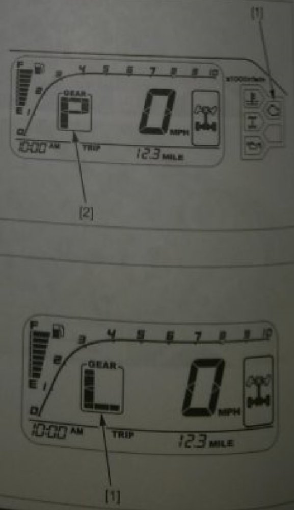

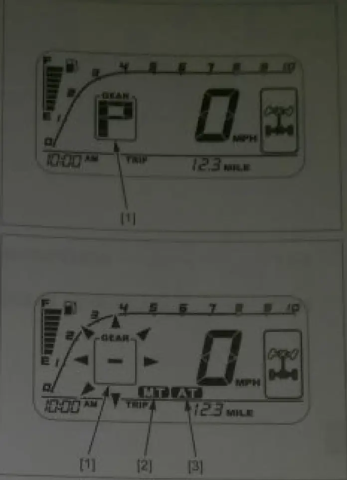

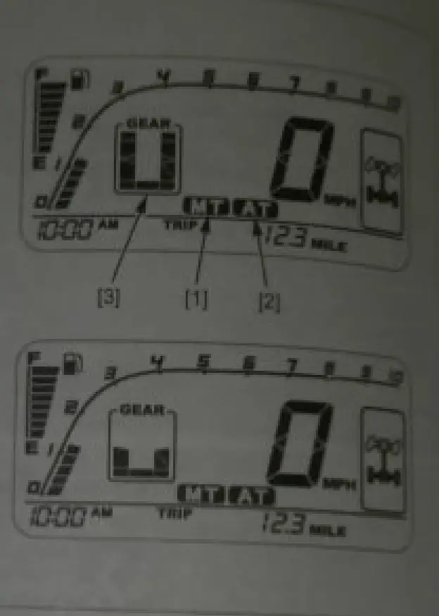

Honda Pioneer 1000 Clutch Initialize Learning Procedure
Before starting this procedure, check the following:
· PGM-FI system & DTC system have no codes
· Engine speed idle is normal
· Sub-transmission in in “P” (parking) and cooling fan stops.
  1. Warm up the engine to the normal operating temperature 122-230 degrees F
    NOTE:
    - If the PCM is replaced with a new one, when the ignition switch is turned on the “MT” indicator [1] and the “AT” indicator [2] will be displayed to indicate that the clutch initialization learning procedure is necessary.
    - If the large “U” (extremely low oil temperature indicator) or the small “U” (low oil temperature indicator) is displayed on the gear position indicator [3] the engine must be warmed before proceeding.
  2. Turn the ignition switch ON (l). The MIL [1] will come on. Wait until the MIL goes off and the gear position indicator [2] displays “P”.
    NOTE: Do not turn ignition switch to START (ll), If the motor is running the learning process will be cancelled.
  3. Depress the accelerator pedal fully.
  4. Release the accelerator pedal.
  5. Depress the accelerator pedal fully.
  6. Release the accelerator pedal.
  7. Depress the acceleration pedal fully AND HOLD IT!
  8. Move the shift select lever to “L” (low range) position. Check that the gear position indicator [1] displays “L”.
  9. Move the shift select lever to “P” (parking) position. Check that the gear position indicator [1] displays “P”.
  10. Move the shift select lever to “L” (low range) position. Check that the gear position indicator displays “L”.
  11. Move the shift select lever to “P” (parking) position. Check that the gear position indicator displays “P”.
  12. Release the accelerator pedal. Check that “-“ is displayed on the gear position indicator [1] and blinks at an interval of 2 seconds, and both the “MT” [2] and the “AT” [3] indicator are displayed in the bottom center of the digital gauge.
    View attachment 11287 View attachment 11285
    NOTE:
    - The PCM is ready to clutch initialize learning when the “-“ is displayed and starts blinking at an interval of 2 seconds.
    - The PCM did not accept to start clutch initialize learning if the gear position indicator continues to display “P”. Perform the initialize learning procedure from step 1 again.
  13. Start the engine and let idle for approximately 60 seconds. The clutch initialize learning is successful when the “-“ on the gear position indicator [1], “MT” indicator [2], and “AT” indicator [3] disappear.
  14. Stop the engine.
  15. Turn the ignition switch on. Check that the gear position indicator displays “P” and either the “MT” or the “AT” indicator comes on.
NOTE:
· If the “-“ starts blinking at an interval of ½ second, the clutch learning is unsuccessful. Perform the process again starting at Step 1.
· If the large “U” (extremely low oil temperature) or the small “u” (low oil temperature) is displayed on the gear position indicator, warm up the engine until the “L” on the gear position indicator goes off. Stop the engine and perform the procedure from Step 2 again.
· If both the “MT” & “AT” indicator are displayed, the clutch initialize learning is not complete.
