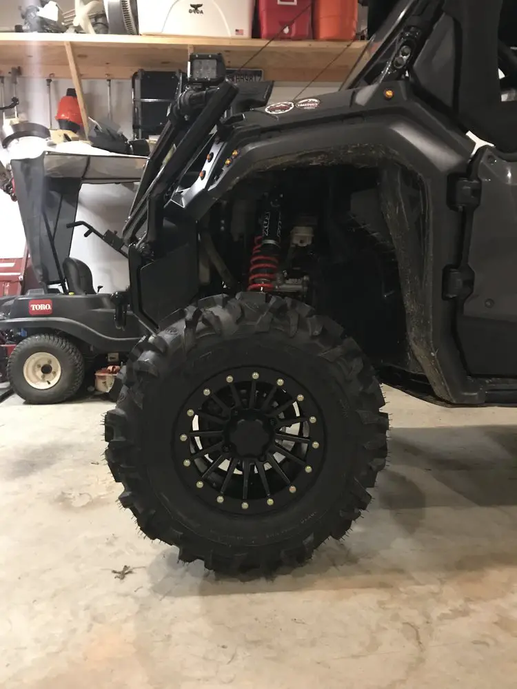

I took a break to put the kid to bed.

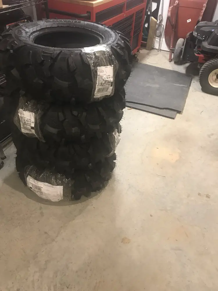

She’s sitting on 28.75’s, which is 3” taller tire than the 25.5” tires that came on it from the factory. That’s factory BigHorn 2.0s at 15psi and Blackwaters at 8psi.
I had them on my 700 out of the 4 different tires I had on it the Blackwaters were my favorite jack of all trades. They are a true 8Ply vs the 4ply /6ply rated BigHorns so I worry less about punching holes in them like I did my BogHorns.

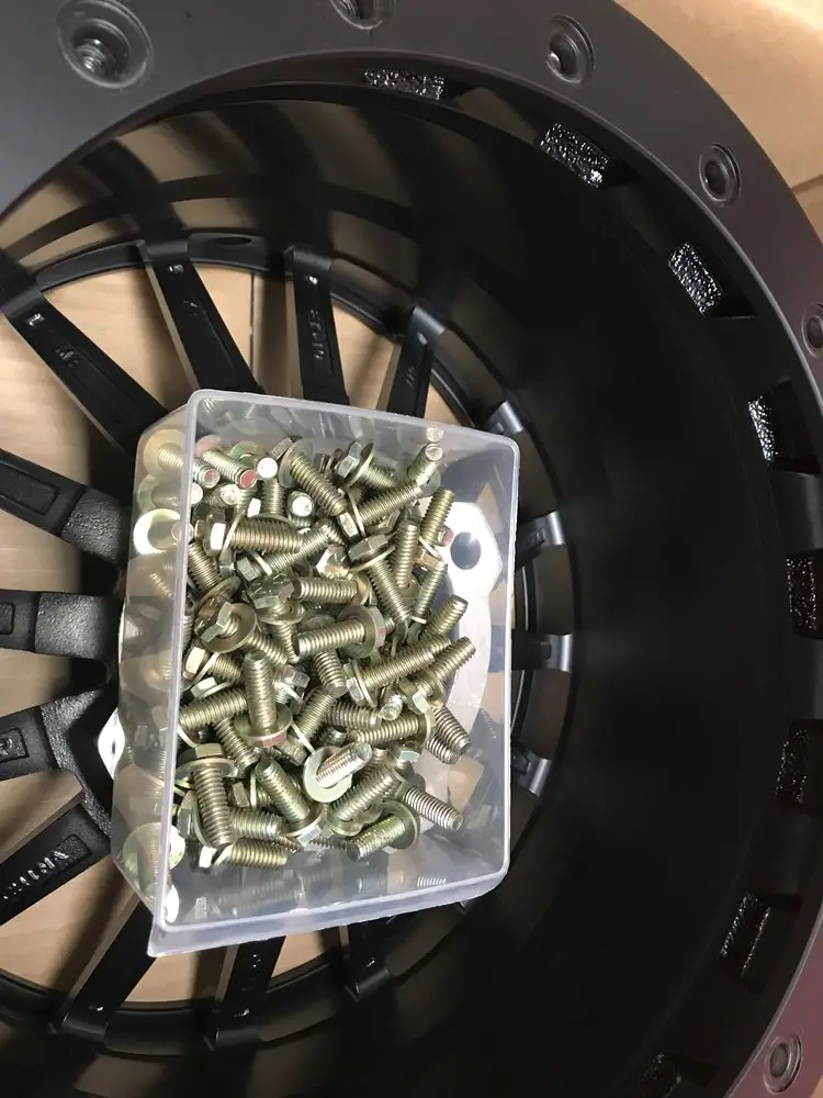

The Dual Beadlock and tire weigh about 15lbs more per corner vs the factory combo.
I considered “true 30’s” but decided I was going everywhere the guys with true 30’s were with my almost 26” tires and squaty stance. With 3” taller tires and the Fox Shocks putting the right height back at factory(with factory tires) I’m plenty tall. Not adding a lift or Roctanes, although I think they are by far the toughest tire out there.
Looks great! You can now get rid of any excess tire tools. If plug doesn’t fix a leak- just keep on riding cause that tire is not going anywhere.
