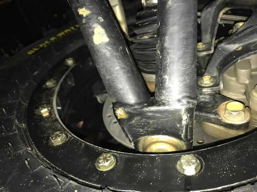

A2679543 8F03 47D3 AB88 2407F810CD74 During cleanup from riding yesterday I noticed the SuperATV a-arms JUST rub the inner beadlock at full lock. I took a grinder to the under rim and cleaned the sharp edge off. Then hit the SATV arm and took about 3/16 of an inch off that corner and now there’s plenty of clearance at full lock.

View attachment 63211 During cleanup from riding yesterday I noticed the SuperATV a-arms JUST rub the inner beadlock at full lock. I took a grinder to the under rim and cleaned the sharp edge off. Then hit the SATV arm and took about 3/16 of an inch off that corner and now there’s plenty of clearance at full lock.
Good catch! I bet that would be razor sharp after rubbing for a hundred miles.
