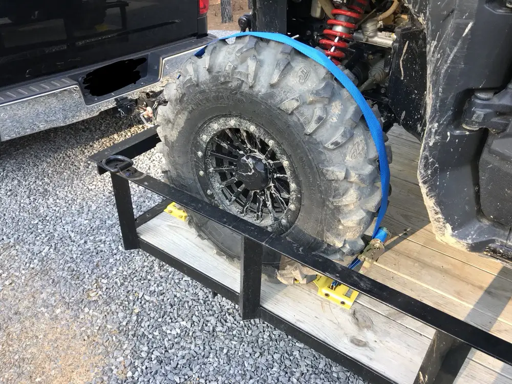

Well I found 3 pair of these at Tractor supply for $36 so I decided I would try them. They will fit a 28.5” tire I’m not sure thy have the length to go around a true 30” tire.

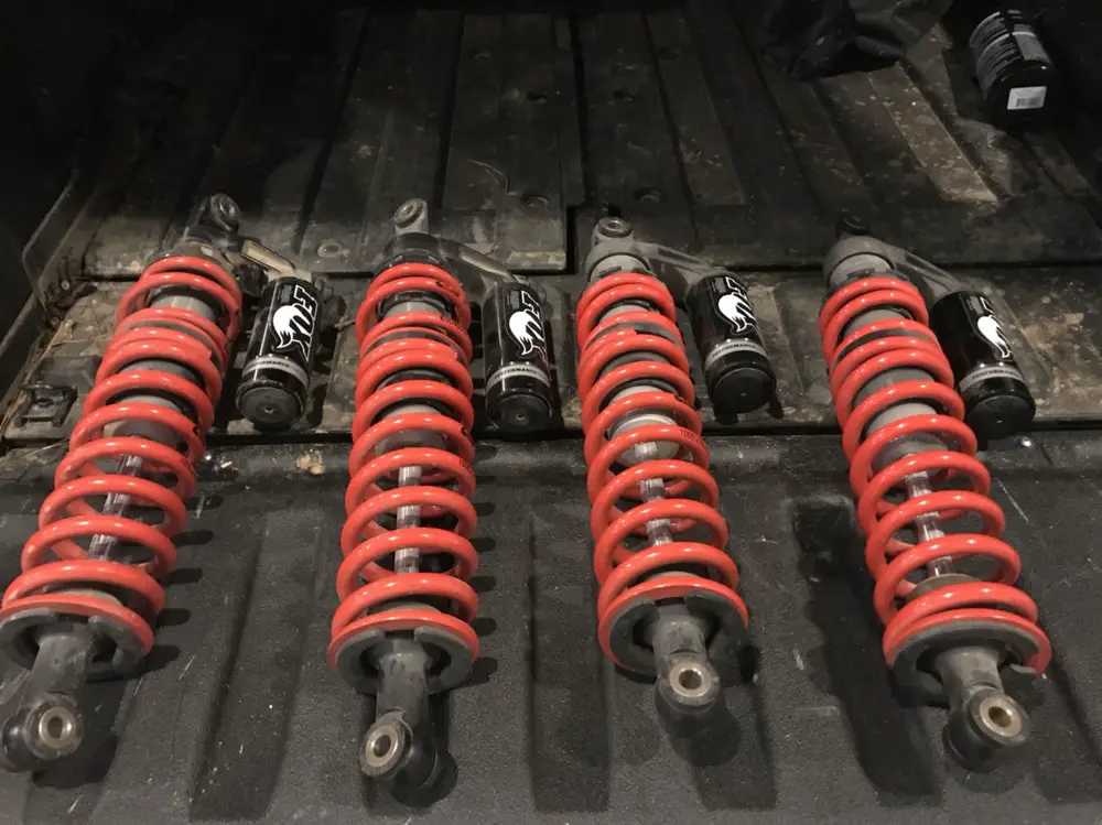

Fox QS3 only have pre-load, and 3 settings. (I have dual springs so I have the ability to adjust spring crossover)
I have them set to stock ride height with stock tires. There’s just more weight than bone stock.
Works pretty good on softest for most riding and technical trails, mid for faster rough trails, and hardest if I feel like getting some airtime.
I’d NEVER get the stage 5 Elkas adjusted.
I found "spots" (holes/openings) in the under-frame I could place the hooks in and ratchet it down. Works great, pull the rear ones forward, and the front ones backwards.
It just takes a little time, I haven't had much time to mess with mine. And haven't put very many trail miles on yet. After Mulberry went two clicks stiffer on the high and two clicks softer on the slow speed compression, think I'm getting close! And it's going to be sweet!
I’ve got shackles on the front bumper and welded a d-ring to the trailer frame just behind the hitch, and I tie to the ROPS on the back down to d-rings I welded at the rear corners of the trailer. People praise these things so I figured I’d spend $35 ($50 with the required Grade8 5/16” bolts) and try them out since I needed some new straps anyway.
It is much quicker to tie down and I don’t have the long straps that always end up loose in the wind no matter how well I tie them to themselves.
