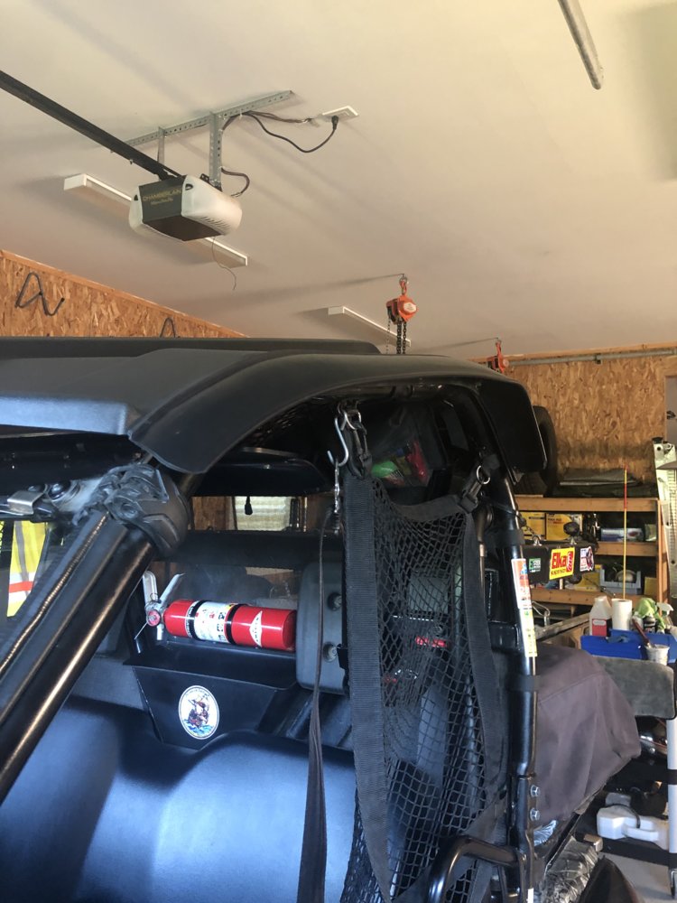

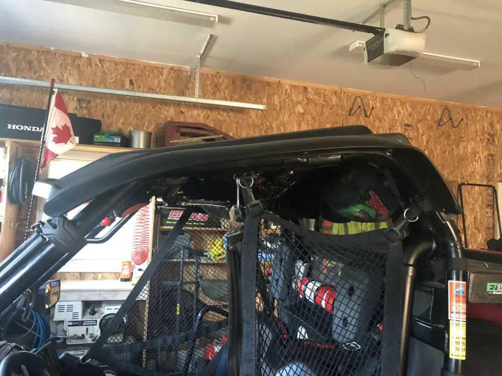

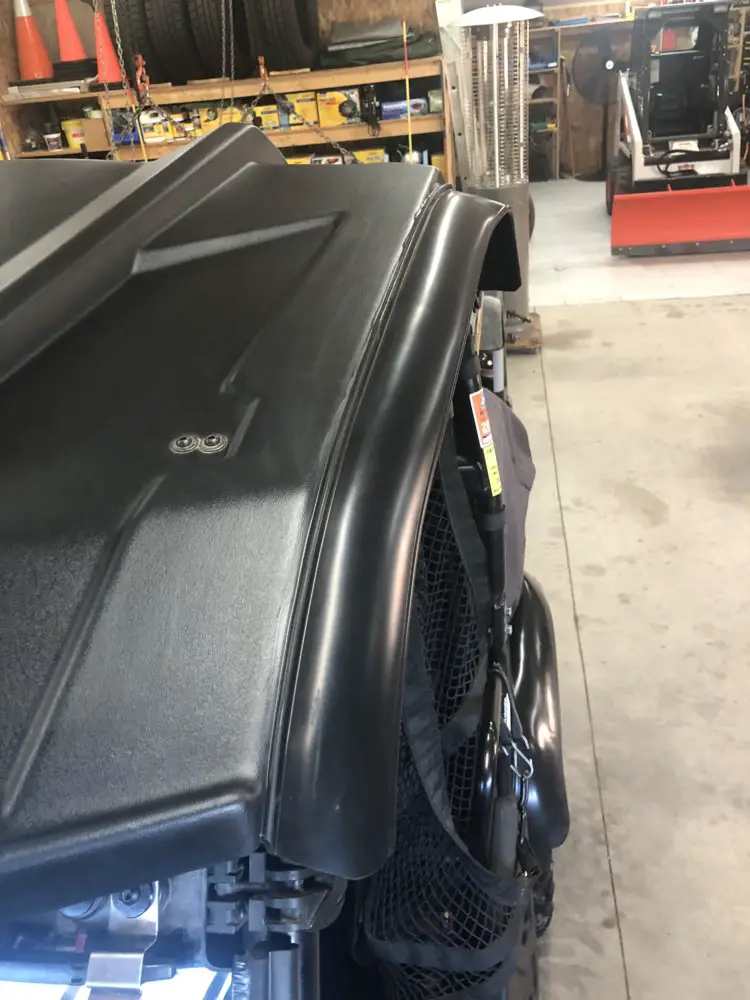

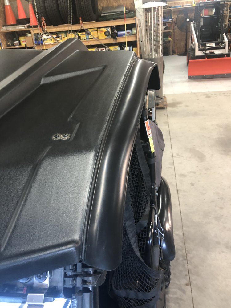

Mudder, I had exactly the same problem with the factory roof: I just installed 2-1/2" Flexy Flare along the side edges. It hangs out just enough to move the drip outside the door and it looks factory. I attached it to the roof with plastic push-in body clips and caulked along the top edge.
John
2019 07 30 180931 2019 07 30 180922 2019 07 30 180850

Wow, that looks like a solution to my problem, your right it does look factory. So where is the best place to get a flexy flare ?
I ordered mine online from Low Range Off-Road: I bought 7' which was plenty for both sides. Make sure you order this sku # as they have 2 different syles with different mounting options.
John
