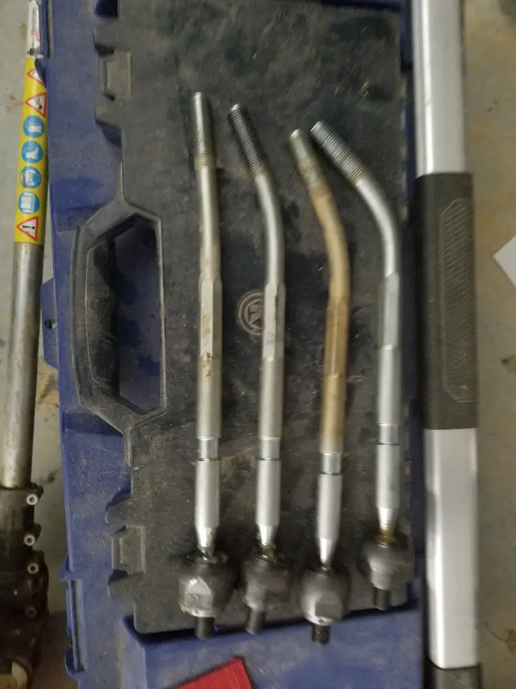

@Delton we must have hammered things pretty good, went to replace the driver's side tie rod, went to lining it up and the passengers side was bent too! Glad I ordered 4 of the sets when I did.
Getting a nice little collection of them, think I might press them straight and maybe try a sleeve over a set.

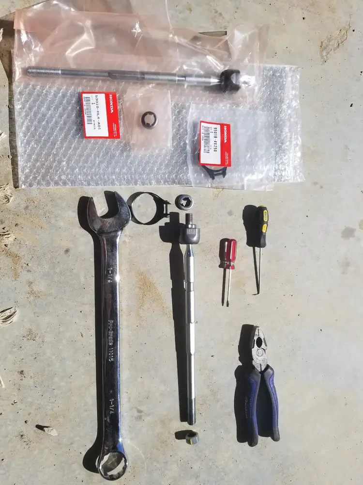

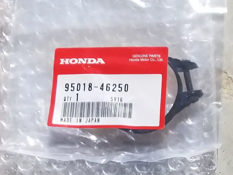

Here is the parts you need, note the band with a screw, it fits the large end of the steering boot since the special one gets destroyed trying to get it off. Thanks to @lee who pointed out this part 2 years ago, the band fits a 1984 ATC110 intake and many others, lol.

Is the band in the bag it came in? Showing the correct part number?

Even clearer thanks

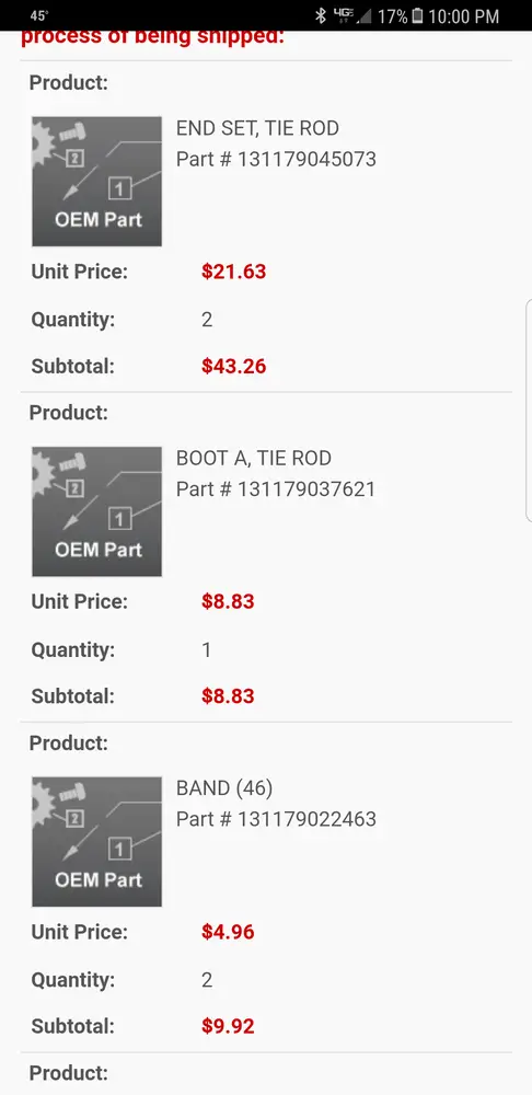

PS... RMATV is stocking those clamps in thier KY warehouse. I have bought 4 of them they arrived next day with the tie rod sets.
Even though OEM Honda parts here is the RMATV.COM part # for reference.

That part number doesn’t come up on RMATV.com. I need to order some replacements. I’m due for a bend.

I think @JACKAL has a few extra bent ones.
Bet he would give you one for the cost of shipping. ;-)
Just put them on drivers side you can flat track with the best of em. :D
Ya, I've got aplenty of boomerang tie rods, better than bent A-arms and tabs ripped off frames though.

Hmmm. Well here is the Honda part #s top label is clamp and bottom is tie rod end set.

Yeah it's much better lol. But ripping that tab did expose a weakness (I think its a weakness anyhow) in that one tab mount. That is thin material with no gusseting. I'm gonna reinforce the passenger side before takeover. My rig loves to slide off into ruts and that's what ripped mine in the first place.
