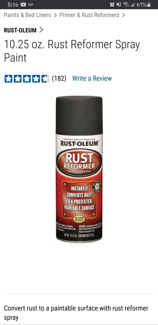

Do yourself a favor, as I posted earlier in this thread, before painting the inside of the tubes, convert the rust to ferrous phosphate by applying a weak solution of phosphoric acid (this is sold at Home Depot in the paint section and is commonly called metal etch or prep, etc.) Sold on Amazon too. At Amazon
You can spray it, brush it, swab it on, then wash it out with water after the time period (typically 15 to 30 minutes) in the directions. Let dry and then paint. This provides a good base for the paint to adhere to and you won't be trying to paint over rust - which seldom works well.

Por 15 makes some good stuff for that too

I agree on the rust converter. I've used this in the past then painted as well. It stops rust and seals really well. My steel road plates sit out in the open 24/7 for years and they look "Like New".
1677329275245

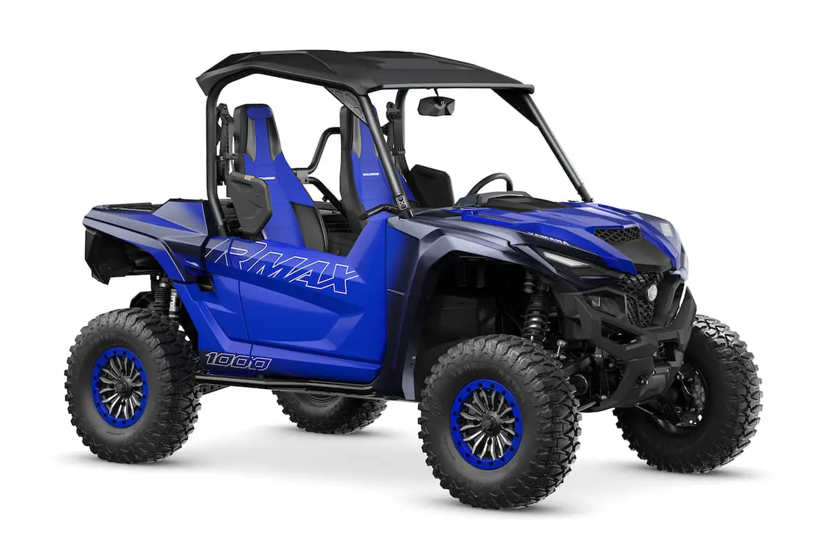

I didn't know Henry Ford had rusted frames and crooked mufflers..............
He didn't have fuel injection either.
Here you go, you can start reading about RMAX problems here: Oops, we're not perfect
I'm sure you can find rust issues too.
