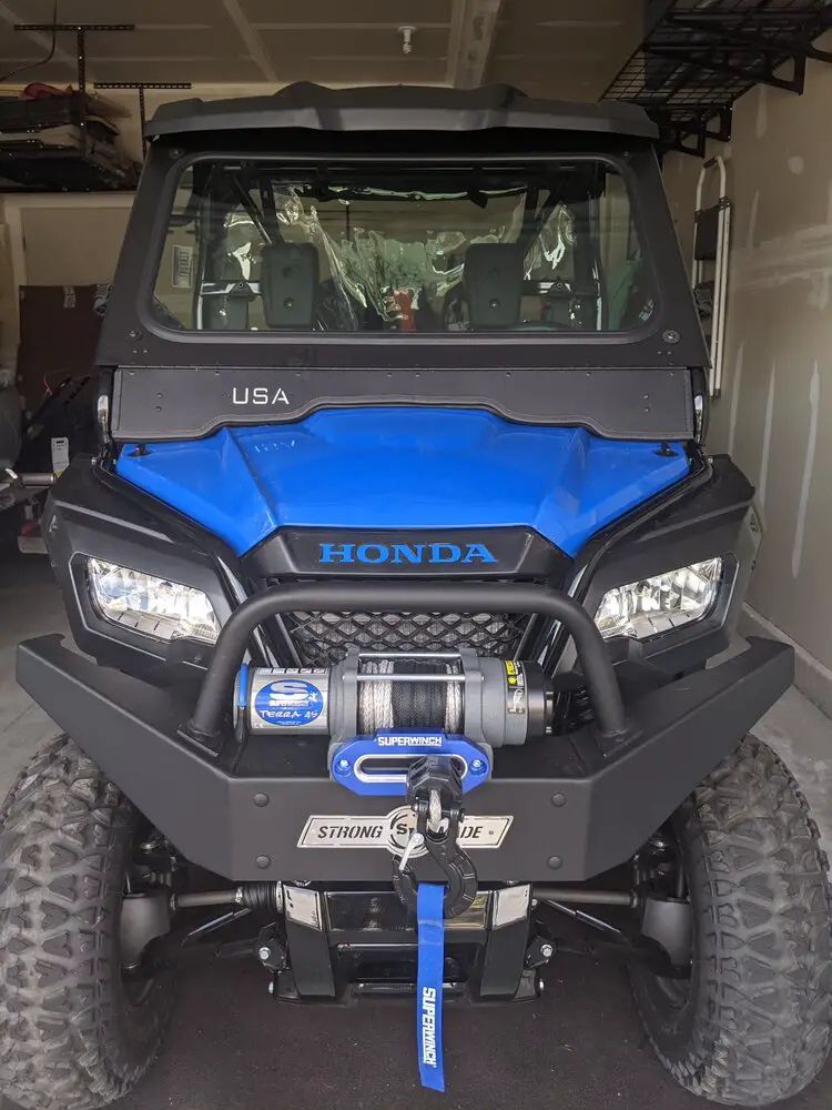

Well she's finally wired up. I connected the winch switch and the power steering key-on to the Honda accessory harness. Planning on working on the fuse box/relay next week and cleaning the wires up some more.
I just needed to get things wired and working for the trip tomorrow. Haven't connected the battery yet and spooled the winch, so fingers crossed it all works tonight 🤣
