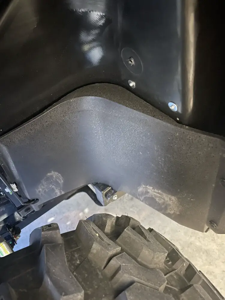

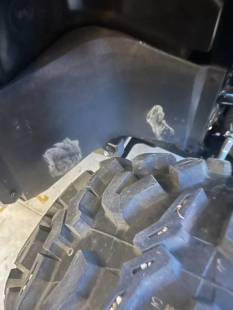

Started thinking a little more about the rubbing situation on the front tires at full lock...wondering if anyone has attempted a heat gun to move the liners in? I am planning on taking the liners out and checking the clearance with them out, but it seems like once I get past this little hump, there shouldn't be any problem clearing through the gap....
1625756795968
Need to check if there is any sort of frame/wiring/etc behind that spot its getting hung up, but hoping I can heat gun it and use a baseball/softball and move it back a 1/4-1/2 inch to clear. Other option is to grind it I guess....I need to price these liners out haha.
Anybody else have ideas or am I on the right track? Don't think adding a spacer would help. Really would like some forward arms, but not many options there either. I'm not going down in tire size 🤣

I would try exactly what you said, heat it up and push it back a little. Adding a spacer might help that situation but then you run the risk of rubbing the wheel well at the outside. Just keep an eye on the inside as I believe the wheel well plastic makes up the interior foot well too.

Thanks man, I just think I needed a little encouragement to feel good about doing it 🤣

I looked last night to see how much my front tires rub after seeing your pictures. We did a little trail ride last night and it was easy to tell where mine hit:
20210709 021029020 iOS
20210709 021050973 iOS

I didn’t really notice any binding, but I wasn’t really looking for it either. Now I will try to pay more attention

At least Honda realized more protection was needed for the wheel well. Hope the heat gun fix works out.
Thanks! Didn't get a chance to mess with the Honda this weekend, hoping to get to it this week after work one night. Will definitely post the outcome once I get to it - I turned the wheel through the wheel well to full lock and it clears the frame piece and just seems like its barely rubbing to clear through the gap. Fingers crossed the heat gun takes care of it quick

Also took the heat gun to the front wheel liners and made some room to mitigate the rubbing at full lock. Decided it was best to do the heating and molding with the liners off the machine. If anyone is curious, here is what it looks like on...
PXL 20210717 211230955
Off....
PXL 20210717 2115267072
PXL 20210717 211530183
