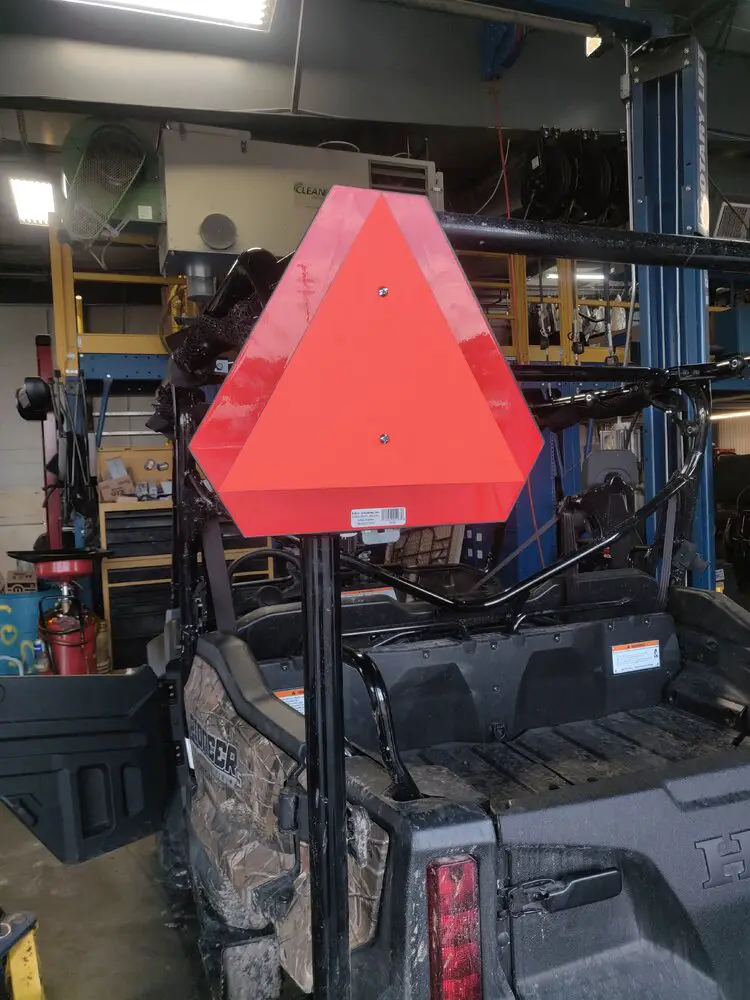

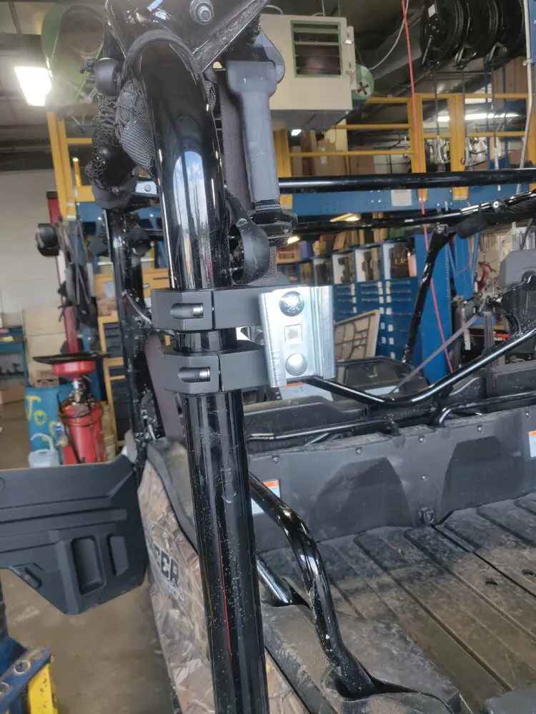

I did some searching on here and I did not see any posts regarding mounting of a safety flag or slow moving triangle to the ROPS. So I did some thinking and came up with a plan and I figured I could post it on here. I bought some led tube mounts and flag spring whip from Amazon. I bought the safety triangle and mount from tractor supply.
For the slow moving triangle I bolted the tractor supply mount to the Amazon led tube mounts. I wrapped electrical tape around the ROPS to get the led tube mounts secure onto the tube and just bolted it all together.

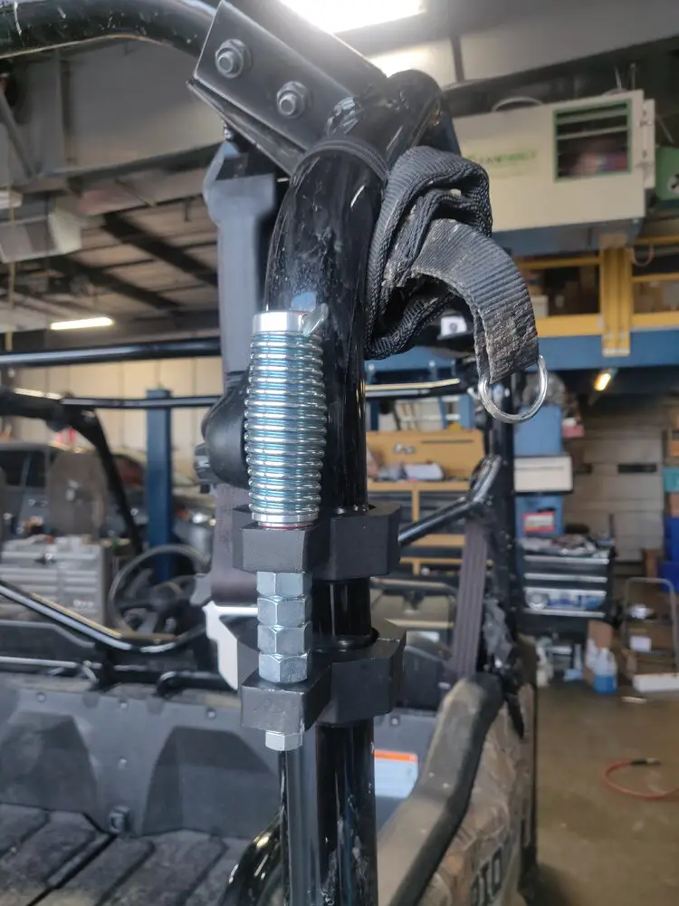

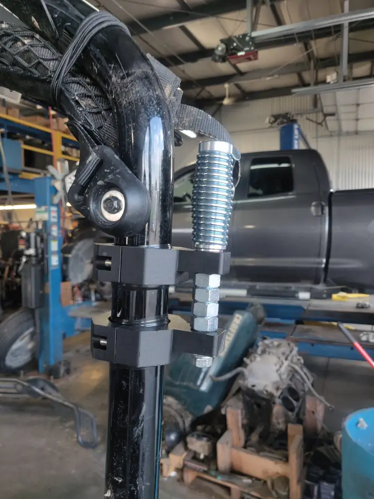

For the flag whip spring mount I used the led tube mounts spaced apart using large nuts. I had a longer bolt for the spring whip mount laying around so I used that to replace the bolt the spring came with. I spaced them to make the whip more sturdy. I used electrical tape on the ROPS to make the led tube mounts secure as well.
This is my mount I used for the safety triangle
This is the mount I used for the safety flag
This is the flag spring mount I used

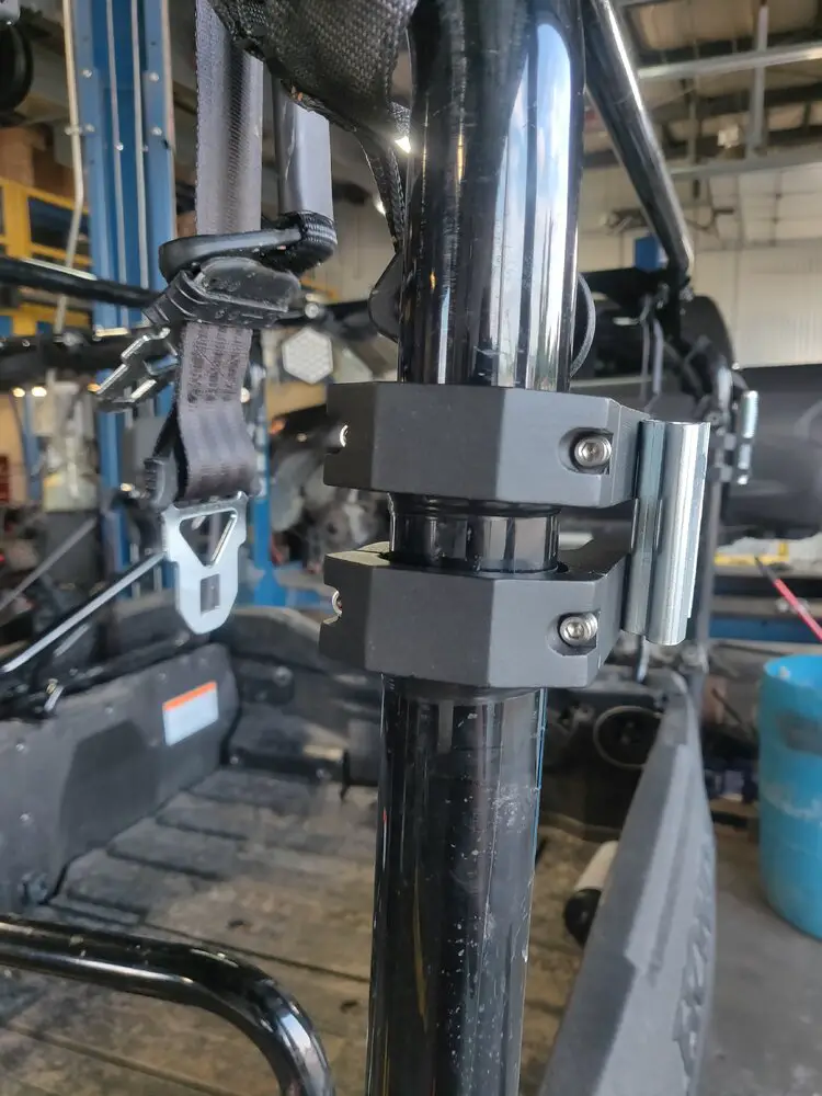

There are only a few areas around that require a flag, like Little Sahara and Sand Hollow, so I wanted a way to quickly attach and detach my flag as needed. I can also take it off when trailering.
I found a heavy duty ROPS clamp with a large enough diameter mount hole for my flag. Two crescent wrenches, one left handed, the other right, will install and remove in seconds. I loosely wrap a bungee up higher to reduce the stress on the pole at the bottom. Works great.
