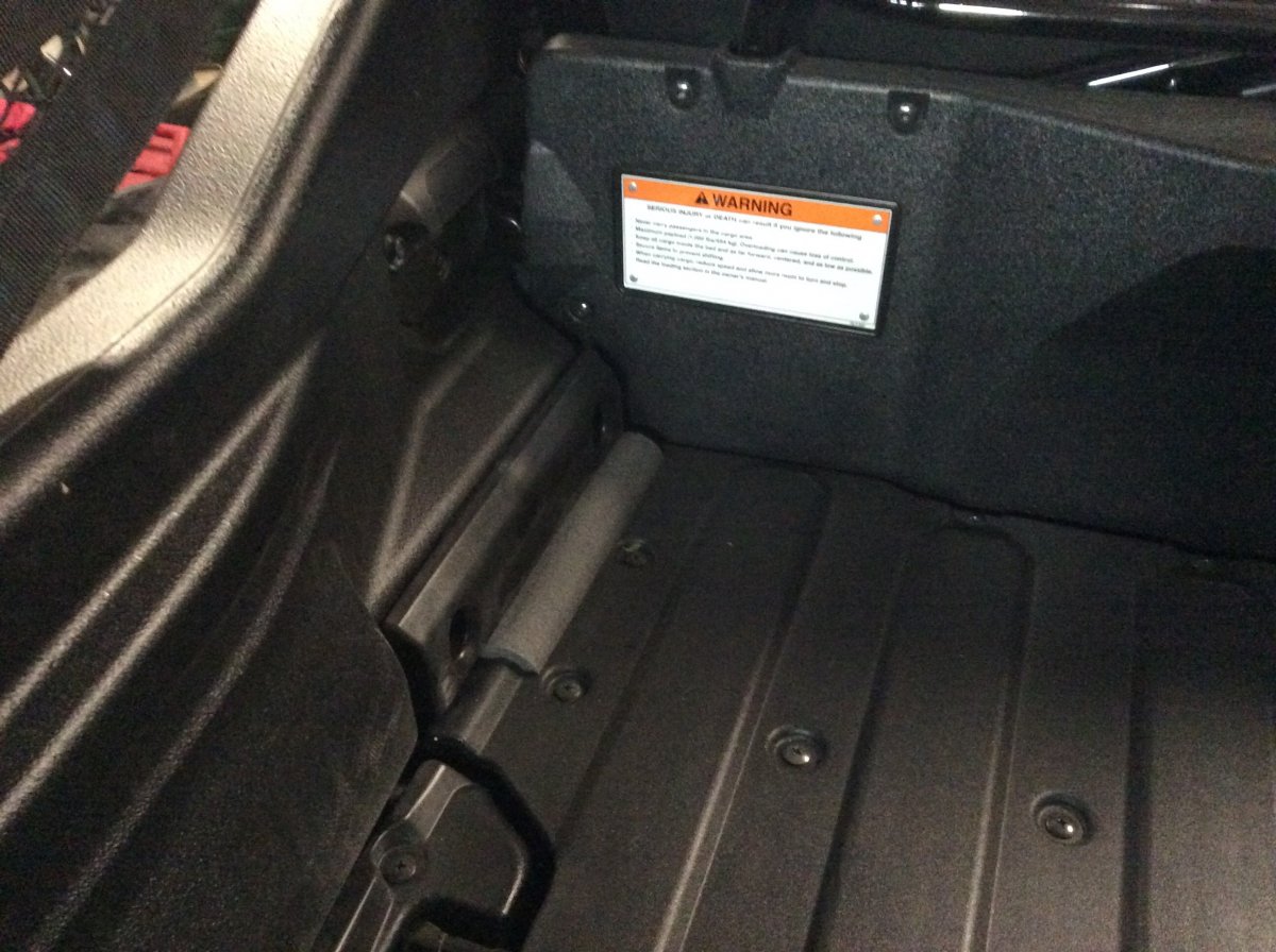

Assembly lines do not have time to make all the necessary adjustments as you like it, they have to pack and ship quick. I got new pioneer yesterday and a few adjustments and test rides later it is fixed. You will notice a lot of rattling with seats down in the back, they have a torq bar for easy of closing so you don't loose any fingers, it does not latch down just floats. After testing a few miles I found riding with seats up no noise, also gives more cargo space. Love it. I did however creat a fix for the bed floating seat noise. I used pipe foam noodle at the door where it holds the seat back down. Stopped the floating seat back. Temporary till I come up with another plan.i will try to get a picture. The bumper adjusts counterclockwise to extend.

I noticed the exact same rattle in the back when the seats are down. All my doors are right and needed no adjustments. can you share the noodle fix for the rear seats rattling? Pictures would be great!
On each rear door they have the bolster that holds down the seat backs when not upright. I simply added some foam pipe insulation "noodle material" on the side of the seat back and shut the doors against it. Just a temporary fix. I noticed thr tops of the seat backs have some shallow rubber as a bumper against there support so I will use some camper foam to dampen the vibration. So far I have achieved silence on my test runs except the bed latches. Very little clearance between the striker and latch so I cannot split a piece of rubber vacuumed line and fix that metal on metal chatter. Still working on this one.
I hope it helps sharing tech tips. I love to tinker on my equipment, no machine is perfect but this one is close.;)

In the manual it tell how to adjust that piece. It is designed to be positioned optimally to eliminate movement. The manual also tell how to adjust the rubber stopper to keep the doors from rattling. All is designed in, you just have to read through the manual. :)
