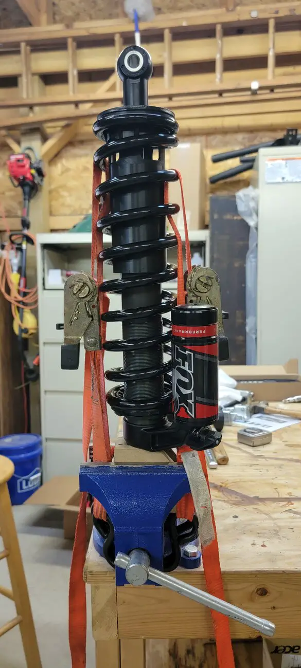

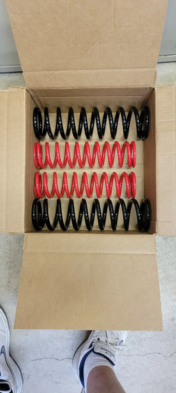

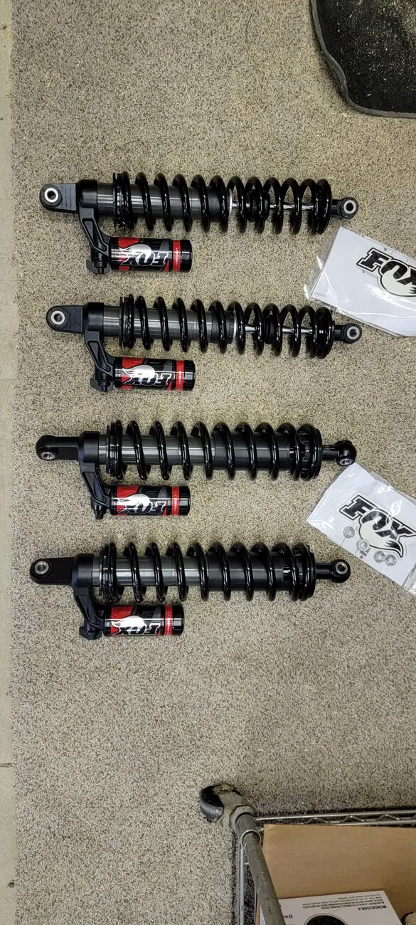

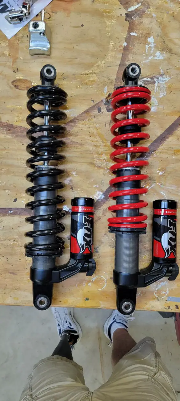

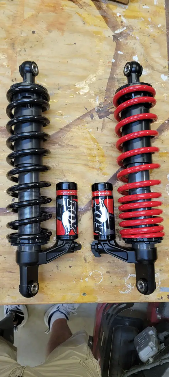

How do u like the ride and height vs stock fox springs? And do you have part numbers of the springs?
It worked well for the weight of what we normally carried. Any heavier and you'd want to go stiffer springs.
I cranked up the preload on the Fox QS3 shocks, so it was probably a bit higher than most, but I liked it.

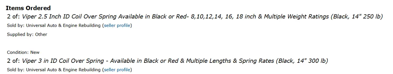

Here's the part descriptions from the Amazon order. I don't think that seller is on Amazon anymore, though.
1744041721155
V
viperr817
Aug 7, 2024
2
2
Oregon, Ohio
Thanks for the fast response! I went with rear 400# hopefully its not too much.
