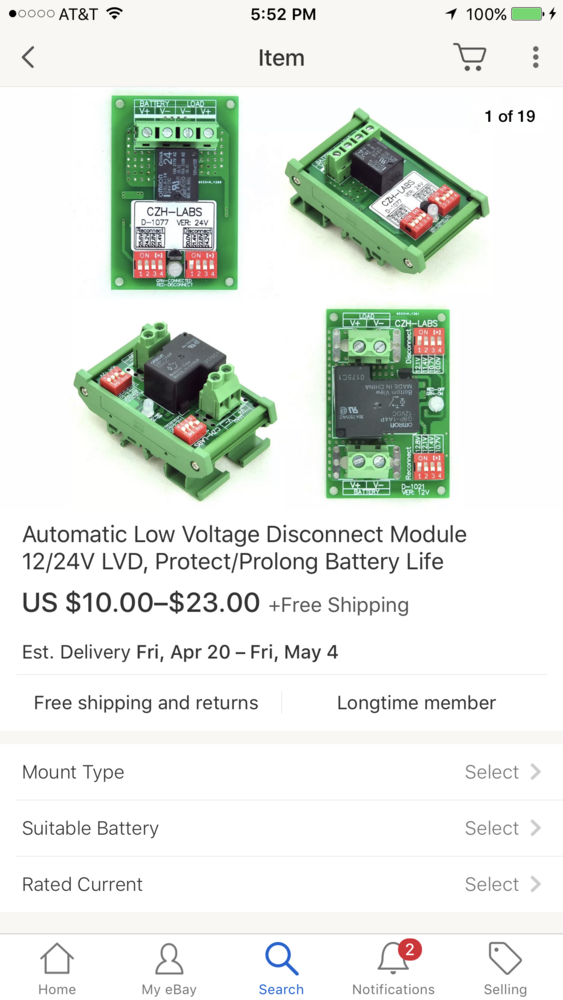

Do you have a part number for the cuttoff switch? I like that idea.
42,062
322,675
Can’t find the exact one but it’s like this however mine is higher volts for cut off
C827D45C E595 41B0 AF61 73C1E8E22E71
Here’s an adjustable one
Low Voltage Disconnect LVD Module, 10 Amp, 12/24V, Protect/Prolong Battery Life. | eBay
Low Voltage Battery Disconnect 20A 12V/24V Auto Detect | eBay
Like this? Won't the elements hurt it being
I wouldn’t mix that in. Sometimes batteries don’t play well together if they are both 12v but don’t hold the same voltage. Never heard of 16v, what’s that for??
i have it for starting the race truck. Gives more ump to spin high compression engines.

they all looked like that. ?? I just picked one didn't read the cut off. You are probably right on the battery Was liking the idea of extra volts and the 16 weighs less. Guess I will stick to the 12 volt. Besides the weight of battery will offset the full fuel tank. Lol
Try “12v low voltage disconnect”
