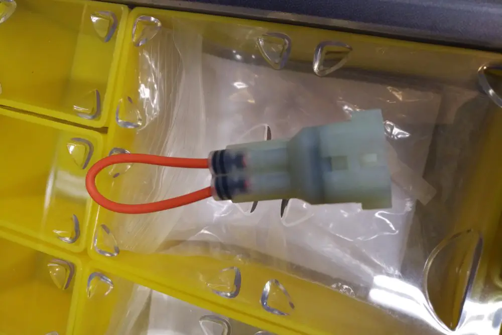

We haven't actually plugged 1 in yet, but Dragonfire has a 2 pin jumper to bypass it.
Its usually listed as being for the YXZ.
I tried to google this to confirm. If you come across a picture let me know.
I know the one of the forum store is correct for pioneers.
Our parts manaher order both of the ones dragonfire offers. The larger blue/black one is for RZRs and Can-Am the sampler white one says it fits Yamaha, but should fit the Pioneer lineup and in turn the Talon.

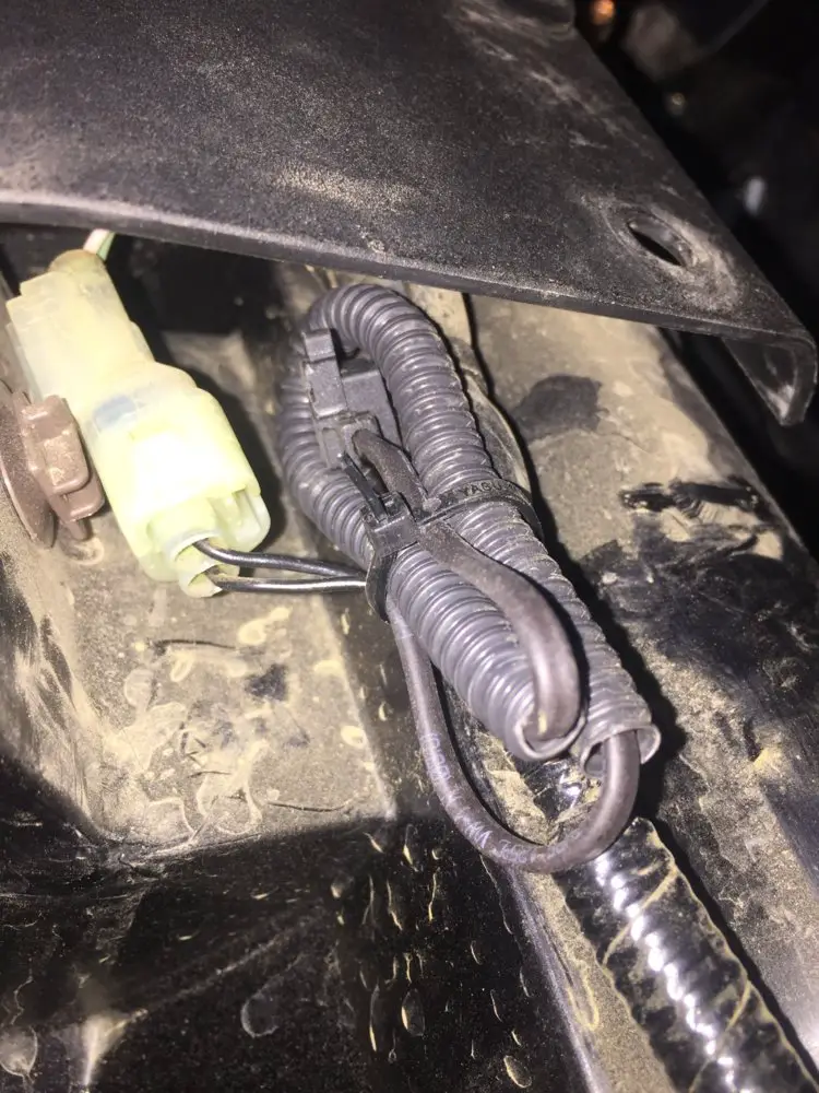

I found that one. It will not work on pioneers. The bypass needed for pioneer is a female receptacle.
You will probably need this for Talons.
IMG 20190216 1448565
You can make it yourself or get the one from the forum store.
Harness accessory seatbelt bypass kit
Reactions: JTW and sharp
The Dragonfire part I was referring to is the male end that plugs into the plug you have pictured.
I looked back at a previous post about the 500 seat belt interlock bypass. It looks like that 1 is the female plug like the Dragonfire part. Ill look and see if I can find out for sure tomorrow.
Yeah.. the plug isn’t overly necessary just cleaner.

This is the plug I found for the yxz.
Capture75
The Honda stuff needs the mate for that. The one I pictured.
