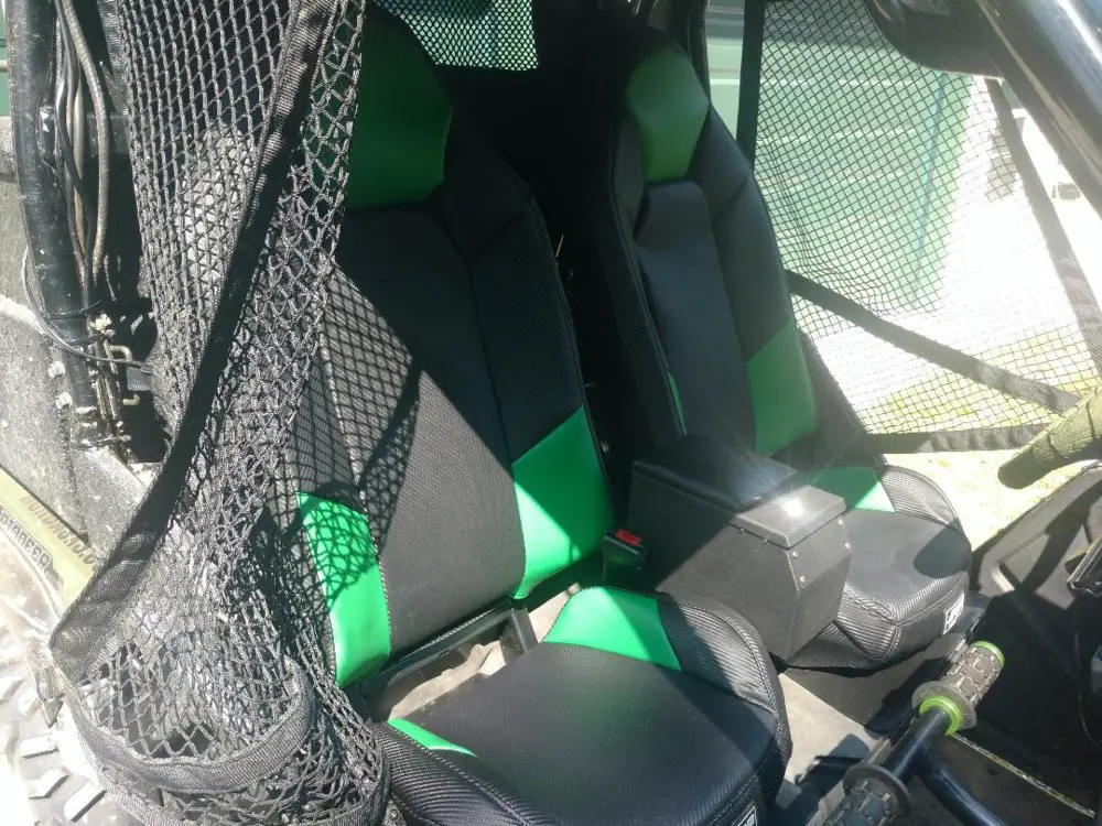

Yeah, unfortunately there's no one out there that'll do this for you. I know the video you're referring to, he wasn't the first to do it but was the first to give us a good look at how he did it. I used his video as a starting platform when I installed mine. Can't speak for his but mine don't move at all. They're way more comfortable than the factory bench seat, especially the lumbar support and the way they hug your sides.

Is that a Choog console? I saw his prototype at RRB three years ago that looked like yours?

First off, thank you for getting back to me. Question did you modify the seats original frame... looking at this picture we can’t tell... and I love the center console! Clever! I would love to see a how to VDO on your build!

Here you go...
