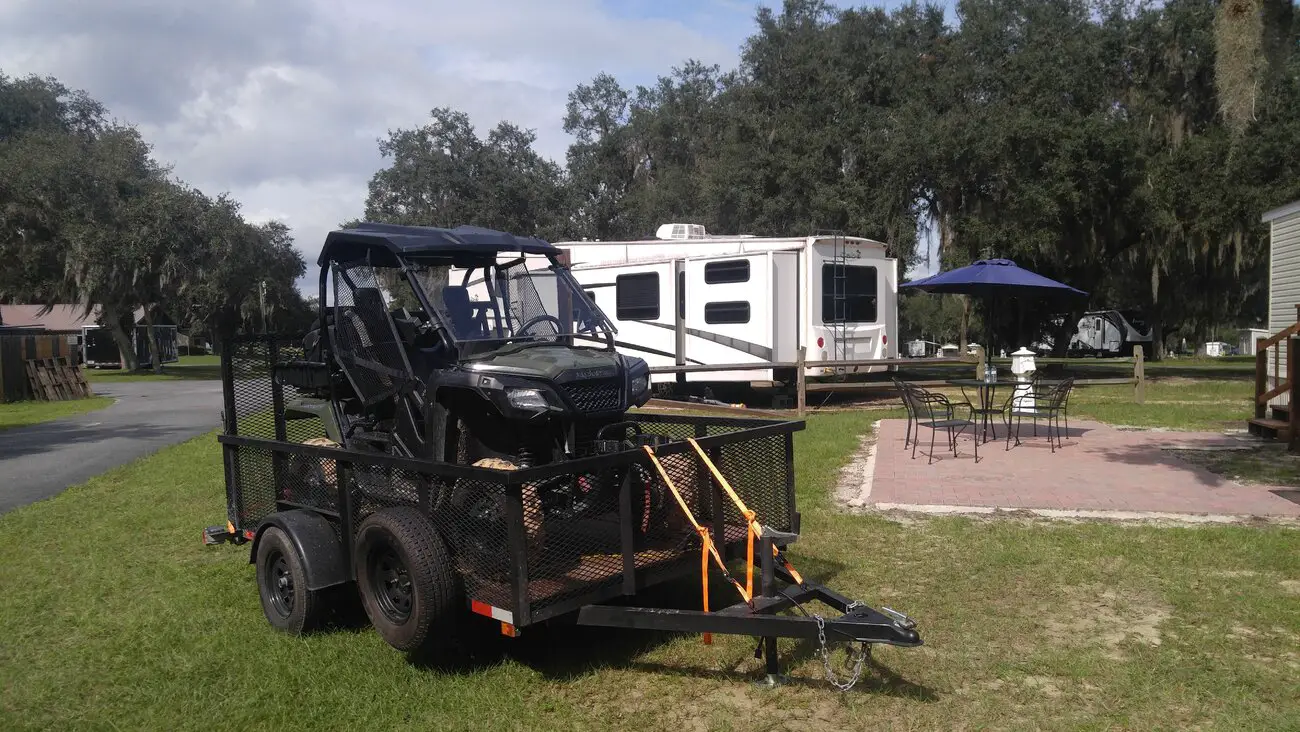

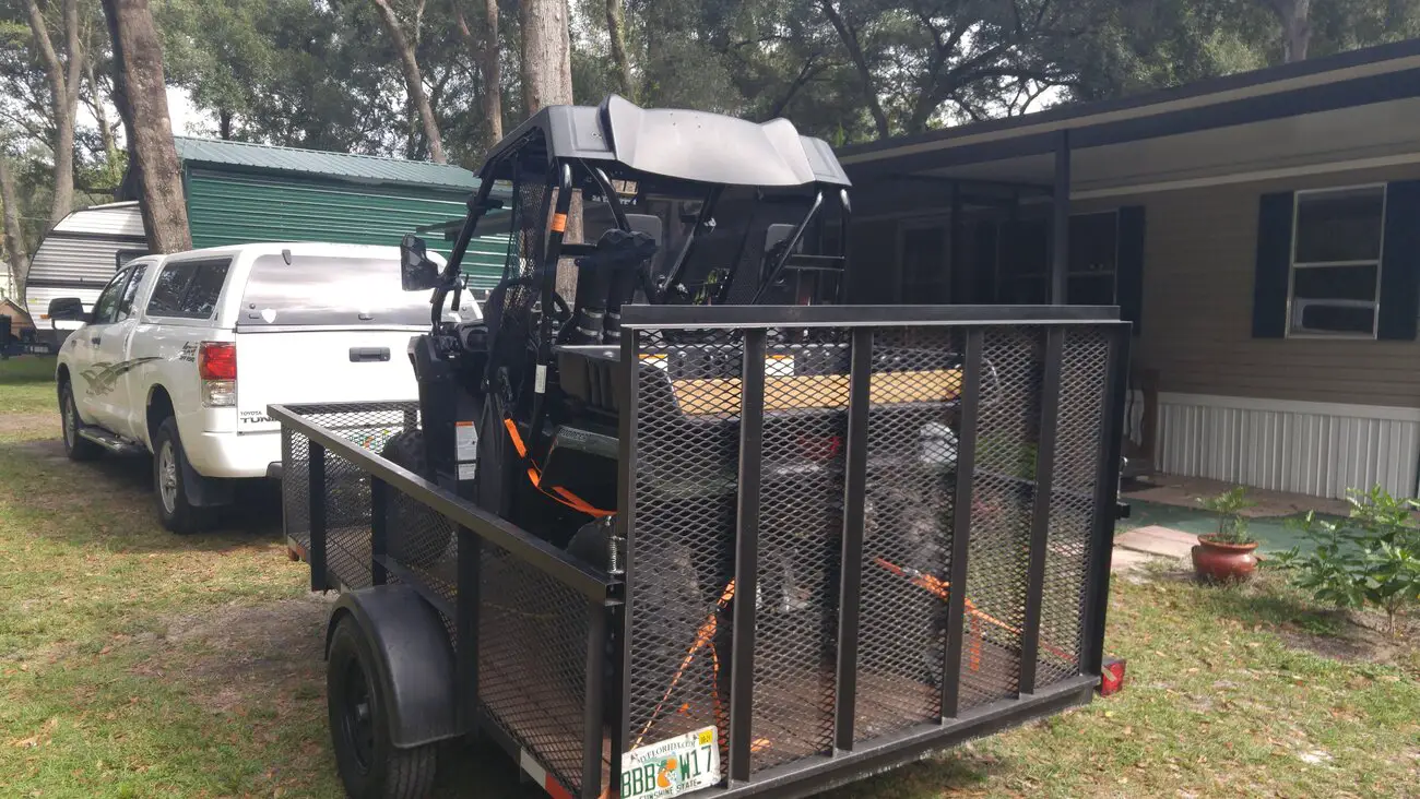

What trigger said use holes in frame to ratchet down.
View attachment 342980 View attachment 342981
We have a trailer just like this at work. We welded a tie down point in the front center on the bottom. Had to cut the expanded metal to do it. Then we shackled a short chain with a hook on each end to that tie down point. We hook the hooks in some holes on the frame of our mule then put it in reverse and pull it tight. We strap the back down with two 2" wide straps to the hitch on the mule. It stays pretty secure like that.

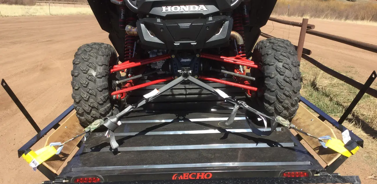

In the beginning, I was tying the rear like this -
1657561559744
But that had a few problems - 1. although tied as high as possible on the trailer, there was still some downward pull on the chassis and suspension. You want your suspension to work if possible and why tire straps or wheel nets with e-track are so good. 2. when I had to move the buggy further rearward to allow for 47 gallons of fuel up front, the straps were so straight across that they didn't have much rearward pull, too much angle.

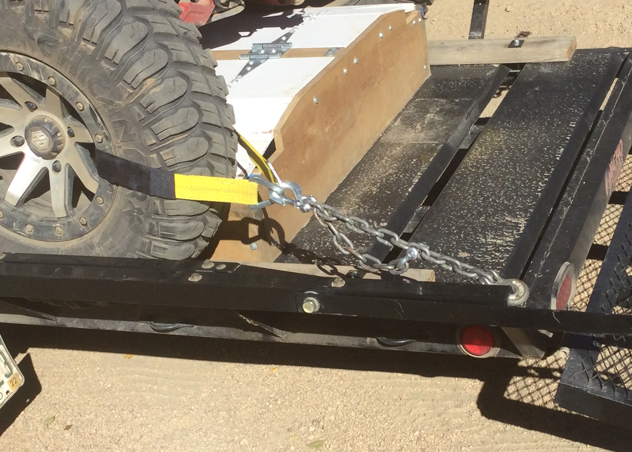

Thinking about it for a while, a lightbulb went on. Although not as easy as 4 ratchet straps, I feel this is much more secure at the rear and easily adjustable for varying loads. This won't work with some wheels, stock Talon for one, the axle strap rings won't fit between the spokes. It's a little slower to load because I have to stop short on the trailer, hook these up, then drive forward to tighten before hooking up the front ratchet straps. That's faster than pulling it forward with the front straps.

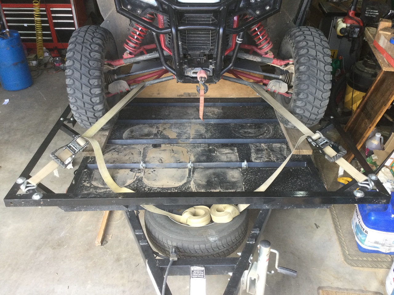

Up front, like this without fuel -
1657562349041
Like this with fuel. The 2" ratchet straps are run around the top trailer rail.

Do the straps going through the wheels wear the finish off of the wheels?

As much as I wanted my spiffy beadlocks to remain pristine, it was not to be. As dinged up as the wheels are, I haven't noticed any strap wear and will accept it as normal wear and tear. The finish is matte black and would be easy to touch up when I touch up the dings.
They were really nice when new, not so much anymore. :oops:

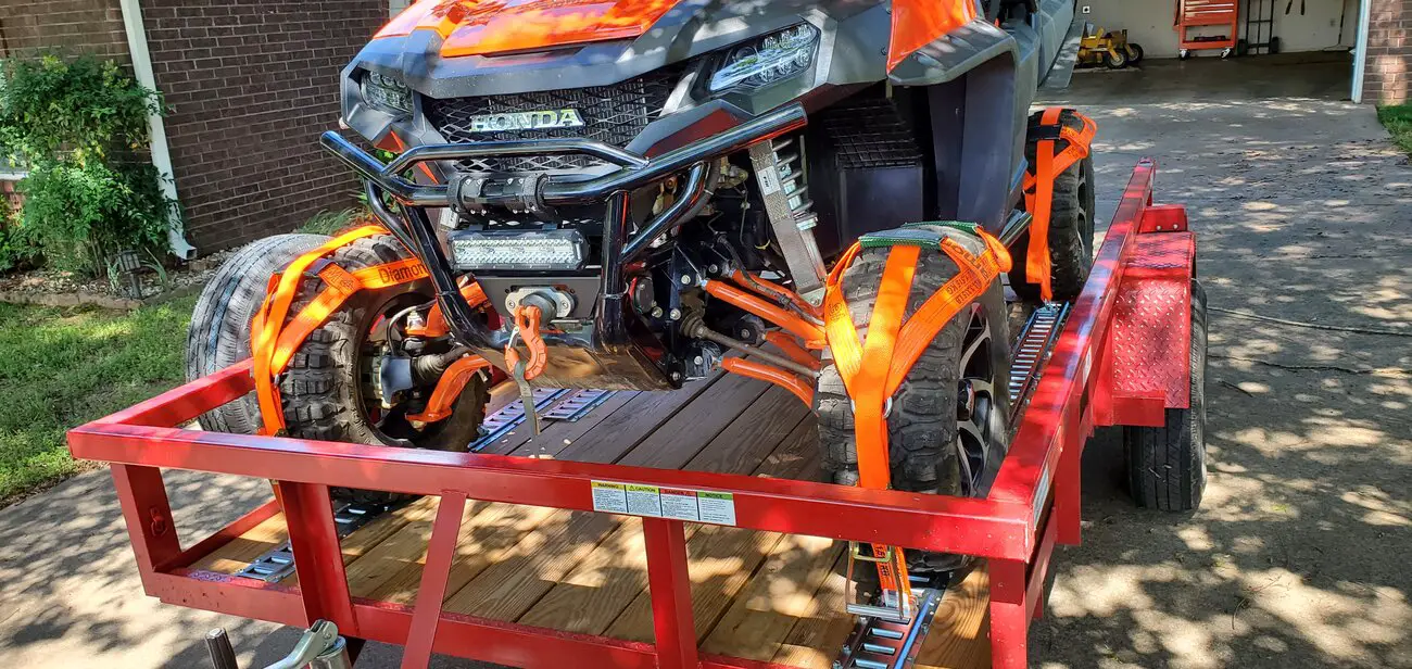

Wheel bonnets with an Etrack system.
