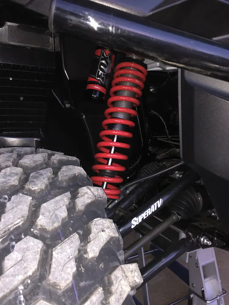

If I understand you correctly, you have Honda LE model QS3 shocks and removed the OEM progressive wound springs and replaced the rears with straight wound 300# springs? And are they 3” diameter x 15” long or did you go with longer than stock spring?
Thank you for your response to this problem.
Correct, I have a deluxe and put on the Fox QS3 shocks but also replaced the factory progressive springs that come on the Fox shocks.
If you do a search it’s on here, I forget off the top of my head but both front and rear are 14” springs but I think the fronts are 2.5” and rears are 3”.
Best pictures I have and preload is cranked down on both front and rear, I’m running 30’s but you can zoom in and look at the springs.

Few pics I found when I had the stock Fox springs With zero preload set, the rears are tightly packed even with no preload. Also the fronts had no weight on them as it was jacked up.

The rear shock pic is pretty identical to my new, rear Fox Shox regarding the top coils in mashed, bound state. I‘ll continue to look around for anyone that may have P1000 R&D experience with this shock and a dual-rate spring set up. I’m not anxious to throw money into replacement spring sets that may/may not work out for me. IMO, a better quality shock package can be purchased with correct spring rates for model specific UTV for about the same $$$$. Sure appreciate your help though!
OBTW, the photo of your R Rear tire makes a beautiful statement 🇺🇸👍 God Bless our country!
The rear shock should be identical, it is the stock spring. I’ll take a closer pic of the rear but if you look at the pictures above that my new springs are grey but you can see they aren’t packed there is gap between the top coils.
