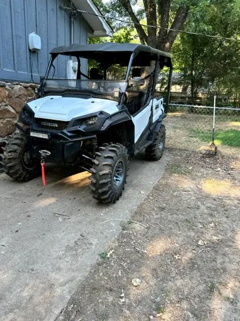

My apologies good sir. I have 2 Boss Audio sound bars. One 18" and one 27" both wired to accessory battery on a switch
Nice buggy!
