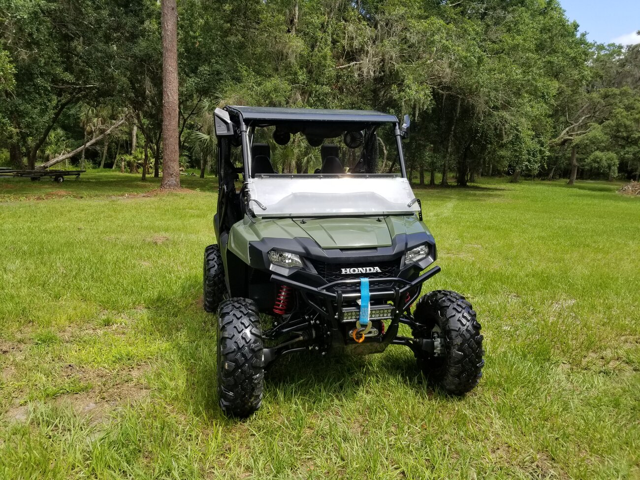

I could be wrong but I didn't think they made offset a arms for the 700? I had spring spacers on the front shocks of my 700 and they stiffened up the ride and didn't bottom out the shocks. I also had super atv bracket lift front and back. I definitely liked the extra ground clearance. I've read on here that the commander shocks are the way to go. A lot better ride and I think they get you 2.5" of lift.

I could be wrong but I didn't think they made offset a arms for the 700? I had spring spacers on the front shocks of my 700 and they stiffened up the ride and didn't bottom out the shocks. I also had super atv bracket lift front and back. I definitely liked the extra ground clearance. I've read on here that the commander shocks are the way to go. A lot better ride and I think they get you 2.5" of lift.View attachment 297614
Yep they do.

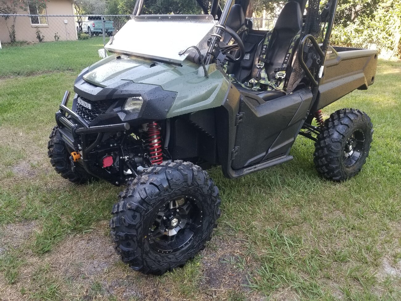

What size tires are those. They look good.

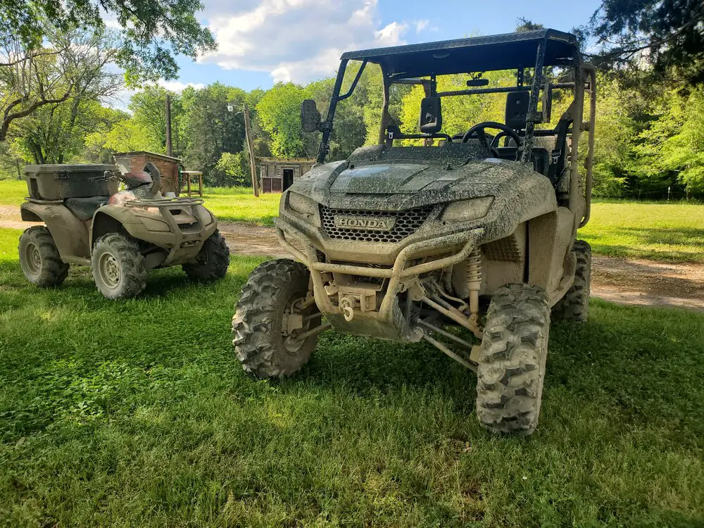

The Super ATV arms are high clearance but not moved forward. Danny Duncan and Moorehead are the only ones making forward arch arms for the 700 This Dannys arms and no lift. 28x14x10
View attachment 349221 View attachment 349222
I can't seem to find Danny Duncan. I found a page selling clothes and one called Duncan racing selling quad parts but I didn't see anything for a pioneer 700.
