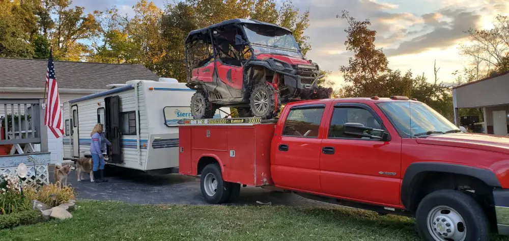

I went dually because I wanted a service body to hold camping and pioneer supplies. I knew the 2,300lb P1K5 would be about 5' in the air and I wanted the extra stability with that much weight that high. So far I have no regrets, but I don't use this as my daily driver other than while camping.
That looks like a rollover looking for a place to happen.
That's a sweet looking setup! Love it!
I was concerned when I started the project about putting it on a truck. I researched all of the commercial racks and platforms and couldn't believe how many are on SRW trucks. I was very happy that the Pioneer fits entirely inside the duals and the truck squats less than 2 inches. I took the truck out and did swerves and figure 8's to see how much body roll I had. The result was virtually none at normal speeds. My last concern was the aerodynamics and obviously making sure it didn't come off. I am very comfortable with the way the setup has turned out. The only part that makes me nervous still is the loading/ unloading. The 10' ramps still seem short. Lol
The boards in the rear photo were for mock up. It now has SS. Brackets bolted in that support the ramps.

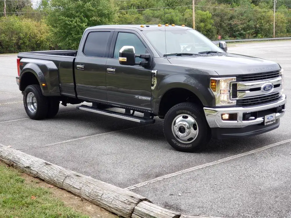

I have had both. The dually is a lot more stable but the fenders are subject to rock pecks and get dirty a lot quicker than the rest of the truck. It is harder to park, a little worse on fuel mileage, can't run it through a brushless car wash and rotating tires is a little more involved. If parking was easy I would still have mine.The duallies look better IMO.
Are they both 4wd...the first pick for some reason looks lower to the ground? Maybe it’s the picture angle?
